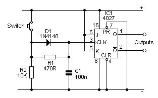

I have constructed this circuit which I found online. I powered it with 12v and with 5v and I cannot get it working. I have checked the connections 1000 times.
If somebody would like to offer a different idea, Im looking for a soft on off switch. I an going to use it so I can use my car alarm to control various of things in the car.
Can somebody please help!!! Im ripping my hair out!!!

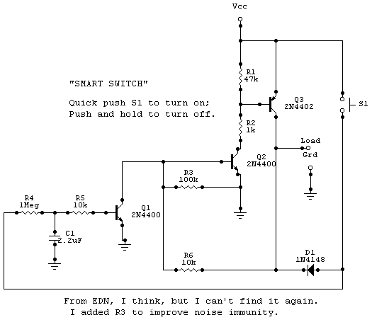

I really don't see how this circuit could work. I think the idea was that if J and K are tied high, the output will toggle with a clock pulse. Looking at the datasheet, there is no such thing. A place to start would be to feed back the Q output to the K input, but I still don't think this is a good circuit. Although it looks like there is an attempt to debounce the switch, I don't know if it will give a sharp enough pulse to prevent multiple transitions of the JK.
If you just want an on-off, try this:
j.
The 4027 will in fact toggle on each rising clock edge when both J and K inputs are tied high. This is not obvious from the state table in the TI datasheet, but it's there. The HEF4027 state table is easier to decipher. I see no reason why the circuit won't work - although it may not do what HellRaz0r1 wants. What is meant by "soft on off switch"?

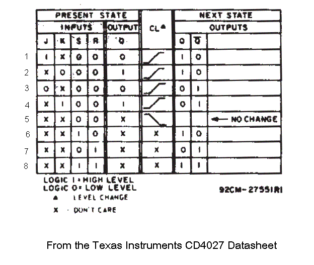

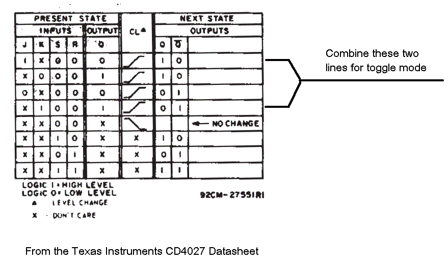

If you do this, the Q output will go low and stay low on the first clock pulse, if it is not aready low. This is not the toggle mode. JKs are designed to toggle when both inputs are high. Below are the function tables for the Philips HEF4027 and the TI CD4027. The Philips table is easier to interpret than the TI datasheet table.
The HEF4027 also has a Schmitt trigger on the clock input, which is apparently not in the CD4027.
I also suspect that the part you have is dead, and you need to try another one.

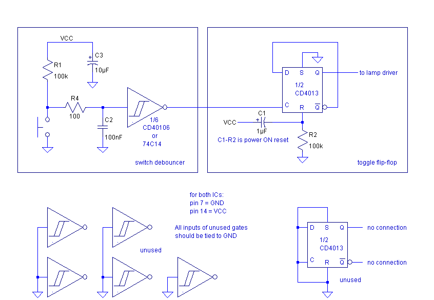

1. You need a Schmitt Trigger to speed up the clock signal. Use a 74C14, 40106, etc. Connect 2 Schmitt sections in tandem (in order to prevent inversion) between the capacitor and the clock input.
2. You don't need D1.
3. R1 should be about 100k in order to provide sufficient debounce.
4. Do you have a 100 nF capacitor across the IC supply pins?
5. The 4027 has Active High PR and CLR inputs. You have drawn them as Active Low.
Len

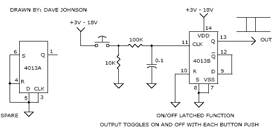

Also I was browsing this site and found these toggle circuits.
Would they be a good alternative because I do not have a schmidt trigger so Im gonna have to get some more IC's anyway.
If you look at the Philips datasheet, you're right. But if you read the TI datasheet, my idea should work. If (Q) K is low, J is DK, then following a clock pulse, Q goes high, K goes high, and so it goes. I find no fault with this logic, though maybe it isn't the preferred toggle mode for a JK. Just looking at the TI sheet, I would have called J=1 K=1 a "forbidden" state. I like the looks of the Philips on better :? .
Now, of course this all depends on nice sharp clocks...
j.
I have included the TI CD4027 table below, with the lines numbered on the left.
There is no line where K is low and Q is low prior to clock. But if you look at line 3, you will see that, if J is low and Q is low, Q stays low after clock, regardless of the state of K.
j.
J=1 and K=1 is not a forbidden state. Line one says that if J=1 and Q=0, Q will change to 1 at clock time, regardless of the state of K.
Line 4 says that if K=1 and Q=1, Q will change to 0 at clock time, regardless of the state of J.
Taken together, this means that if J=1 and K=1, Q will toggle at clock time.
Ron
