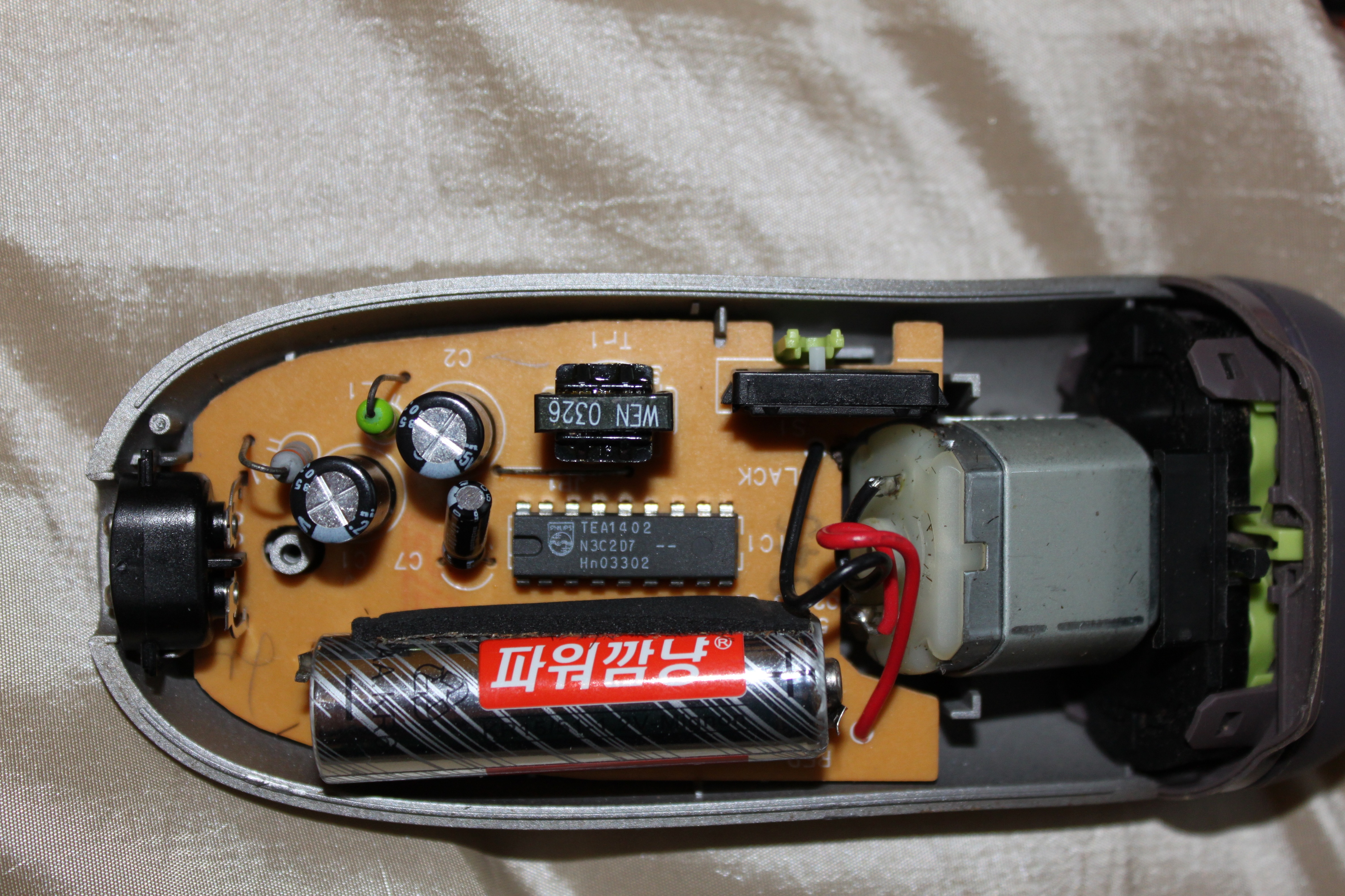

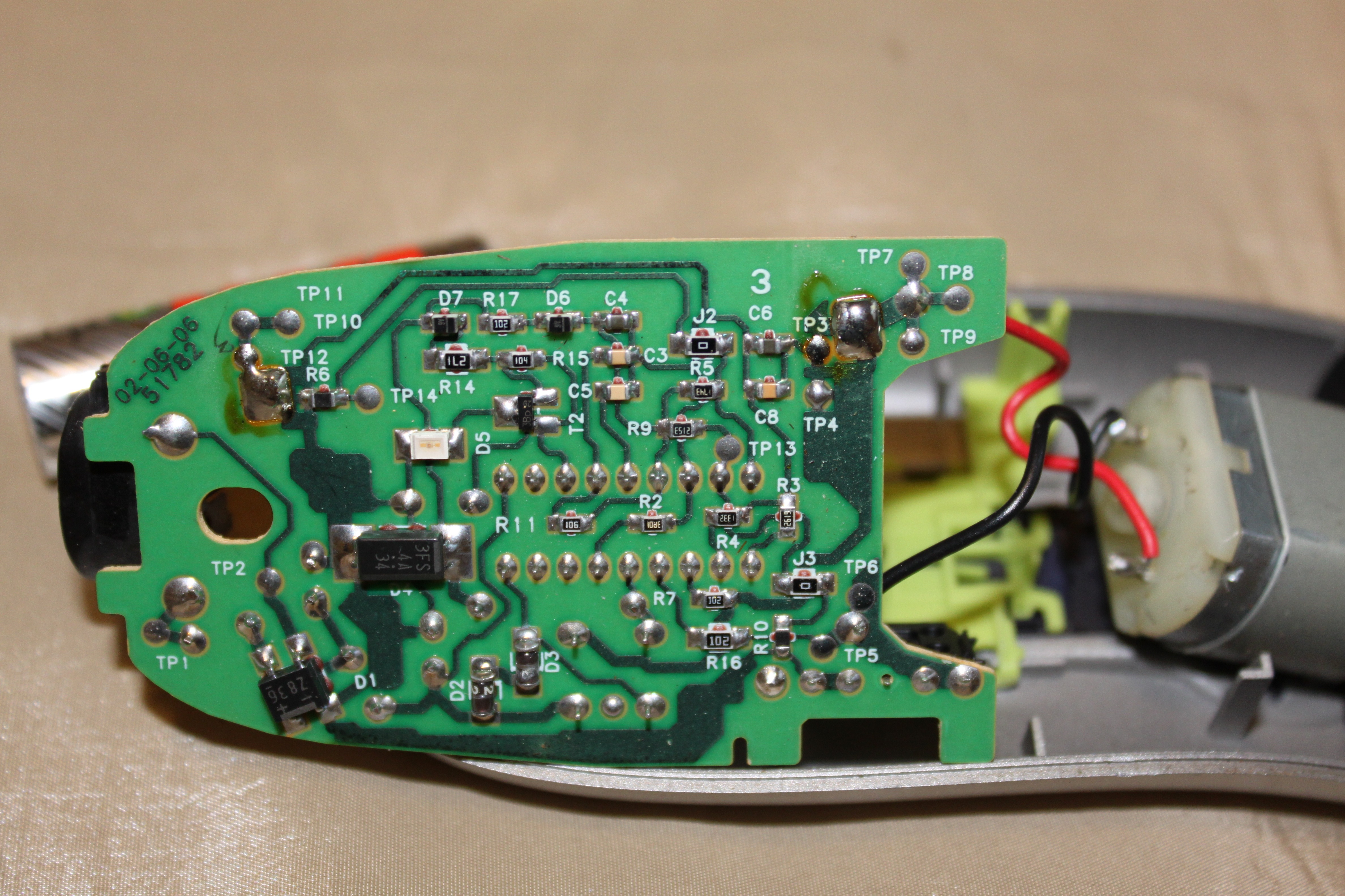

hmm thats expensive! you're gonna need a new shaver! Inverters aren't cheap toys to make. I'd personally open it up and see if it hasnt been boarded to also be exported as a 220v model and see what components are needed for that. Alot of chinese products are mass produced, also intended for the 220/240v market and they all have similar PCB's with different component structures. Post a pic of the PCB (top and back)

hear are a couple pictures if it helps.

On the back it says it needs and input of 220V. Not 110V. It has an electric cord that plugs into a Chinese outlet, not a Canadian electrical outlet. So don't I need 220V not 120V to power it? Also not really wanting to buy batteries and solder them in and desolder every time they run out. Any other ideas? Also I'm really thankful by all the responses. I appreciate the advice and help.
As Bill stated, it might be a safer bet (not to mention simpler) just to use the AA battery.
It's quite possible that the thing will run off 110V directly.
That said, if you know what you're doing, and you want to make a converter, the cheapest, simplest & smallest I found would be a non-isolated converter IC - set it up for boost/buck-boost to give around 300V out ref: https://www.electro-tech-online.com/custompdfs/2011/01/60479.pdf .. There are other similar devices in a 3 pin package too but you'll have to look. The fact that the converter outputs a DC voltage shouldn't matter; the shaver appears to have a bridge rectfier on the input anyway. If you don't really know what you're doing, then I suggest you don't play with mains voltage.

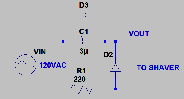

Ok tcmtech, that's probably the best bet. I wrote it off in my head as all the mains (240VAC) rated caps I have seen are huge. As this is just 120VAC, it's not so bad... Also, with the use of an extra diode, the converter capacitor can be a polarised type (& therefore smaller yet again).
So rosspt, what do you think of the attached cct? The capacitor should be an electrolytic, 200VDC, >=3uF, minimum ripple current 75mA. Diodes can be e.g. 1n4004 or 1n4007, resistor can be 1/4W or higher.

Something does not look right about your voltage doubler circuit you have. The one diode should be in series with the output not parallel to the capacitor. Plus being it dumps directly into a largish electrolytic capacitor I doubt the snubber resistor would even be necessary.
Given that he only needs two or three watts at 240 volts the capacitor probably wouldn't need to be much over 2 uf if even that.
110VAC^2*3uF*50Hz ~= 1.8W. 3uF gives about 300VDC @ 5mA (1.5W). Reducing the cap reduces the voltage.
It's irregular as the diode across the cap is to prevent it charging up backwards when initially connected or if the output voltage is ever < input instantaneous voltage; in any other condition is has no effect & allows the circuit to function as you would expect.
The resistor is to reduce the charge current into the 3uF cap, although it could rather be placed in series with D2, as the shaver circuit already has a series current limiting resistor. You are right that it could potentially be removed - although it does reduce stresses on the cap.
