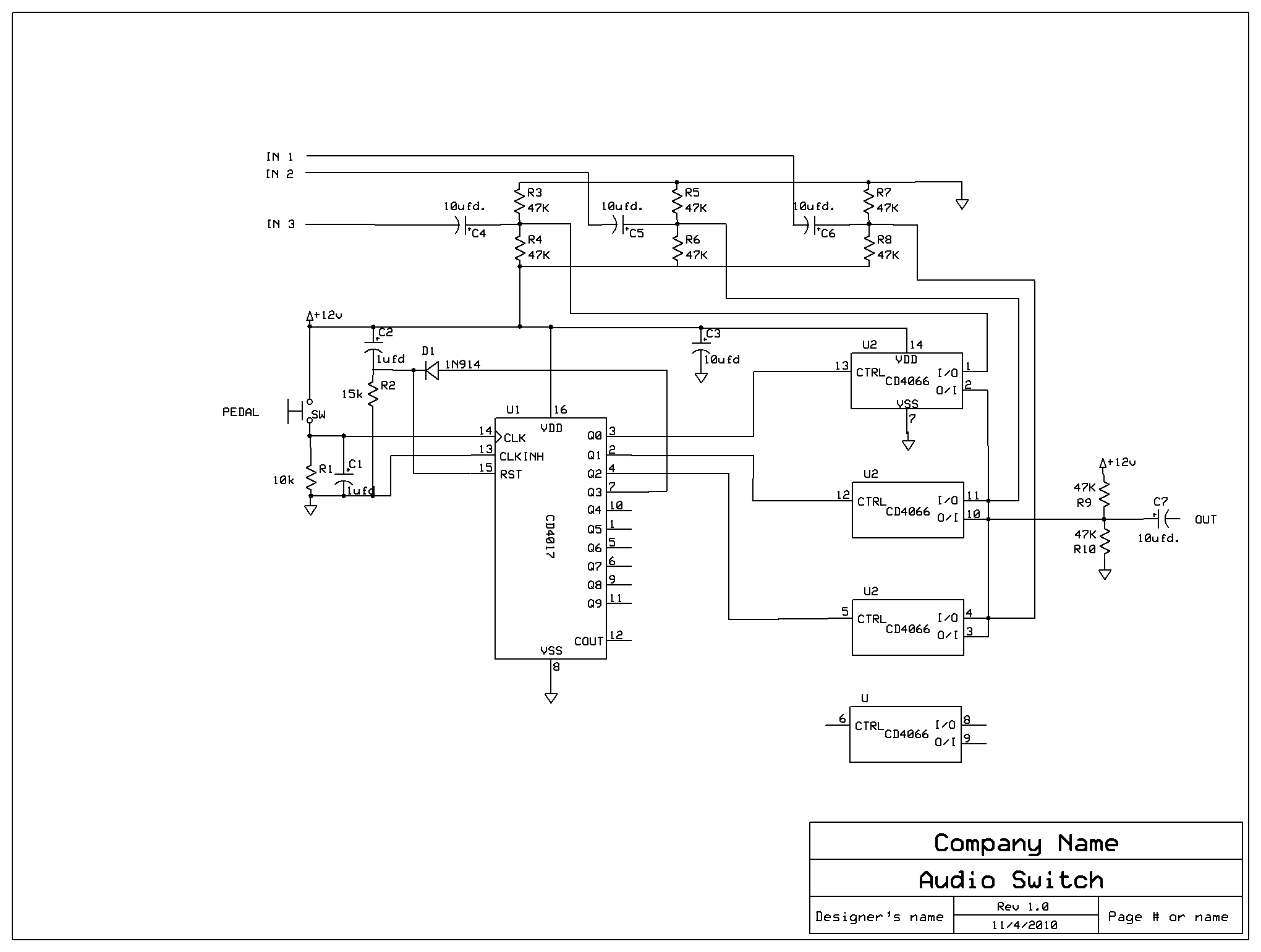

I'm trying to build a switching circuit. It will sequentially select between one of 3 audio inputs. Is there a cookbook approach to this, or possibly a chip that already implements this?

The activation will be via a momentary footswitch. If you're familiar with guitar "stompboxes" (effects boxes at the feet of the player), that's what it'll be for. It has become more and more common for a single player to be a multi-instrumentalist. Instead of running three different signal cables to the mixer, this will reduce it to a single one. The individual instruments will be cabled to this box, into three different inputs. For example, the player picks up an acoustic guitar patched into channel 1, plays a song and then switches to mandolin in channel 2, and so on. At every instrument change, the player will need to hit the footswitch and cycle through the three channels to get to the one hooked to the instrument he is currently playing.
I hope this helps, and thanks for the reply. I've been making analog devices for guitars for some time now, but this is my first venture into digital logic. Frankly, I've yet to grasp some of the concepts. Mostly, I just want to avoid reinventing the wheel if there is a concise approach to this application already out there.

I think this one will work. Lets see if someone will double check it because I didn't build or model it.
A little DC supply will power it.

sure it will work, R2,C2 & D1 can be eliminated, for reset without any delay. ie: pins 15 & 7 will be connected directly. input can be directly wired through 4066 without any resistor, better can have a check to know the difference when assemble.
No!
the CMOS switches have a resistance of some 100Ω.
Better use multilateral switches like MAX312 ... MAX314.
They have an On-resistance of 10Ω (and can stand higher currents), far below the well known 4016 or 4066.
They can be activated the same way.

OK. A little explanation:
R1 C1 debounces the pedal in case it is not a clean pulse. Without it the counter might count several times with one pump.
R2 C2 power on reset to make sure it comes up on 0 and not 7 or 8.
1N914 is reset from + 3 count. C2 helps make sure this pulse lasts long enough to reset all the counts.
All of the dividers with the coupling caps are an attempt to have all the devices switch from the same DC voltage. This will help reduce the "pop" you sometimes hear when switching.
If the lower resistance switches have similar turn on voltages they would have less loss and be better. Don't know about price and availability.
You might want to add a little LED to the output of each count (If you can see the box) so you will know which is selected.
you asked about reset, when it resets it will imediately will give output to #1. (ie if the reset is not set with delay), so when out put#4 (connected to reset) goes high it will imediately (negligible delay in low freq) will turn on out put#1.

Ron, thanks for the circuit explanation. Its always helpful for me to have it laid out like that. I understand that biasing the inputs to around 1/2 the Vs is the way to go with regard to switch popping. The question arises, would there be a problem with establishing one central divider and hooking each input to it, or is the individual approach required?
If my research is correct, the LED indicators would need a transistor driver to buffer the CD4017's outputs due to CMOS's low ouput current. Is this right? Also, as an aside, I've also read (several times) that all unused CMOS inputs must be tied to a specific logic level.

A preamp is a good idea for analogue switches (4066, or 4051/2/3) since they have relatively high on resistance. But using them for audio there are a couple of issues. Firstly, the signal being switched has a limitation of the supply rails. The CD4053 series has a 'VEE' pin, which can go as low as -5V. This is to allow one to route analogue signals that go above and below ground (= audio). The CD4066 doesn't have this facility (as far as I know) so if powered by 9v, the input signal can only be between 0v and 9v.
However, ronv has cleverly added bias resistors to the inputs. The input capacitor blocks any DC offset (so your input signal is centered around 0v, ground) and the two 47k resistors shift this so it is centred at half the supply voltage, 4.5V. Meaning your analogue signal will start to clip at around 4.4V - but most line audio is 1V peak to peak, and guitar signals generally stay below 3v p-p. The outputs are coupled with capacitors to remove this 4.5 offset, returning the signals to 0v centered. The one caveat with these bias resistors is the input impedance. with 47K resistors thats around 23k input impedance. Fine if it is being fed by a buffer, or 'audio out', but if it is straight from a guitar, you'll want a buffer on the input too, one with high impedance.
The second issue with logic analogue switches is the off resistance. As I'm sure you're planning on amplifying the outputs, any 'bleed' through of the signal could well be heard after amplification. Although the off resistance is measured in megaohms, and ron's schematic has bias resistors on the output, there still may be some bleed through in the output from unselected inputs. A quick way to sort this is to shunt the unselected inputs to ground with another 4066, or mosfets. This makes sure NO signal goes though the switch and couples to the output when it isnt' selected. It also prevents 'crosstalk' between analogues switches in the same package.
There are actually quite a few app notes about this subject, because, as you noticed, maxim like to plug their line of awesome analogue switches, and point out the flaws in existing designs. Whilst they are obviously promoting their product, they make some excellent points. - Doesn't mean to say we have to use maxims chips though!
All in all, using the analogue switches can be very useful, but certain precautions must be made for a 'clean' transparent routing of audio, which means a few extra circuits before and after the switches - especially for pre-processed signals, where any noise/distortion/crosstalk is bound to be amplified by later processes in the audio chain.
If you're a guitar pedal fan, you can check out schematics for the boss series of pedals. Their bypass switching uses JFET's, same principle as your idea, just with only two possible channels, works on 9v, is low power, and as its designed for 'guitar input', does very well to keep signals 'clean'.

I think the crosstalk is due to the switches layout on the same die. So here is a thought for you. Use 3 separate 4066's and put the 4 in each package in parallel. This will also reduce the drop by 4X.
Be careful adding to much "stuff". Try to keep the unshielded wire lengths to a minimum or you will have some 60 HZ pickup much higher than the crosstalk.
Add a decoupling cap (say 10 ufd.) from the power supply to the dividers to ground.

I am with Boncuk on this one, the CD4066 is obsolete and is a dooky part. Digi-key has a cost VS. performance compromise part, the DG412. The part cost $3.84 and has respectable specs.
Digi-Key - DG412DJ-E3-ND (Manufacturer - DG412DJ-E3)
Data sheet:
https://www.electro-tech-online.com/custompdfs/2010/11/dg411.pdf
Now crosstalk may or may not be an issue. You have to do the numbers to figure that one out. You need to look at your audio levels you are working with and gain distribution and also switch specs. The DG412 crosstalk is 85 dB down from adjacent channel, so say your audio in chan 1 switch is 224 mv then the crosstalk would be around 12uv which is probably into your noise floor and may be a non issue. Off isolation is another spec to look at, the DG412 off isolation is 68 dB. The part Boncuk mentioned has better isolation specs and lower on resistance but at a price.
