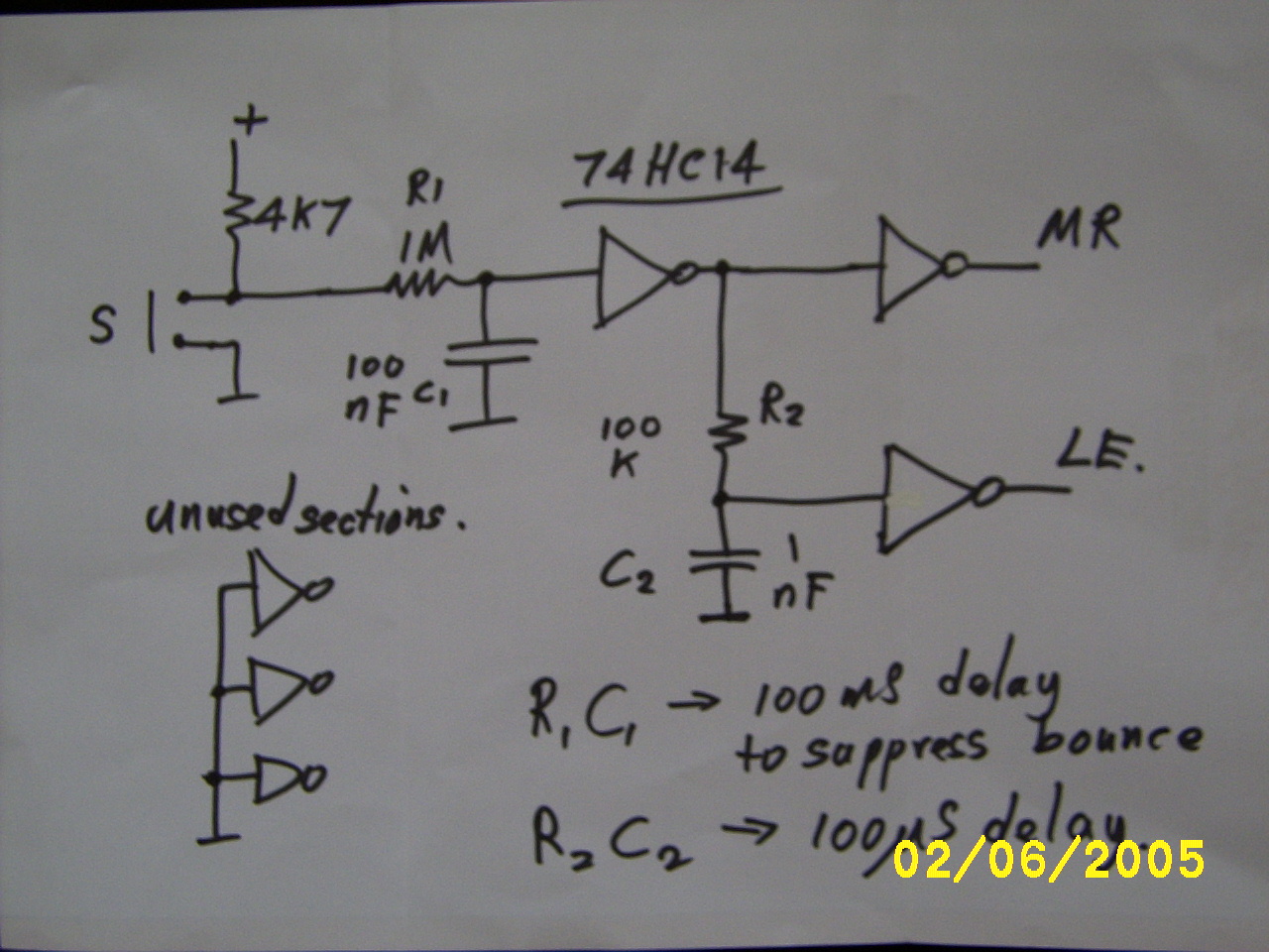

In short, I have two input pins of an IC connected together which appear to somehow change states at slightly different times, resetting the chip.
The chip is a 74HCT259 addressable latch, and the two pins in question are -LE- and -MR-. In my circuit, they are usually both at high, until a momentary switch is pressed, when of course they go low for as long as the switch is held. Now understand that these two pins are jumpered together! The problem is that when the switch is released and +5V is sent to both pins, the LE seems to "realize" the new state before MR, resulting in a complete reset of the chip (and therefore a useless circuit).
How can this be? Does this chip not allow such simultaneous operation of those two pins? My logic levels are good (coming from an RTL NOR gate), and I'm not mixing in analog or anything like that. The three address bits and the data pin are all jumpered high for testing, so that's not an issue. The switch is _not_ debounced (yet), but in this particular case I don't see why that would matter.
Weeks ago I did manage to get it working fine by using a crude kludgy mess of a couple resistors, a capacitor, and diode on the LE pin, causing a slight delay while the capacitor charged. But today by accident I realized it was acting as a voltage divider and the level on that pin was waaaay off... 'twas a miracle it ever worked at all. (Obviously I'm not an expert on such things.)
What I'm going to do next is string together a bunch of invertors to take advantage of propagation delay, which I'm confident will "work". But surely this is complete overkill for something so simple? How do most folks use latches like this? It just seems hard to believe that I need a whole board full of external components to get the latch to do what it was designed to do.

I'm not sure I understand what you are trying to do so I'll explain what I think you mean.
1. select the address and hold D high.
2. reset all outputs
3. latch the addressed output high when the switch is released and remains high. All other outputs are to be low.
If this is what you want, then you need to force the MR/LE states through the correct sequence.
As far as I can gather, when you connected the capacitor and diode, this delayed the LE signal and that circuit worked as you wanted.
So when the button was pressed, MR = LE = Low. When released, it passed through the MR = H, LE = L state and finished in the MR = LE = H state.
If this is true, then it passed through the "addressable latch" state and then to the memory state.
So you want a circuit that generates this sequence. The attachment has 2 delays. R1 C1 to suppress bounce (about 100 ms) and R2 C2 to delay the LE signal by about 100 us.
Len
Thanks for the response Len! Yes, this exact sequence you describe is what will work. Thanks for the schematic, you're a llifesaver! I'll be building this first thing in the morning after I visit Radio Shack for some NPN transistors that I'll need for those invertors. ;) I'll let you know how it works out!

The inverters are 74HC14 Schmitt Trigger ICs. Transistor inverters won't work.
However, before you rush off to the Radio Shack, I have thought further about your requirements.
If I understand what you want, I believe you could have used a less complex decoder such as the 74HC42, the 74HC138 or the 16 line 74HC154.
These do not have a latch function, but I don't think you need the latch function. If so, then you don't need the sequencing circuit I posted earlier. However, they have active low outputs, so this may be a disadvantage.
