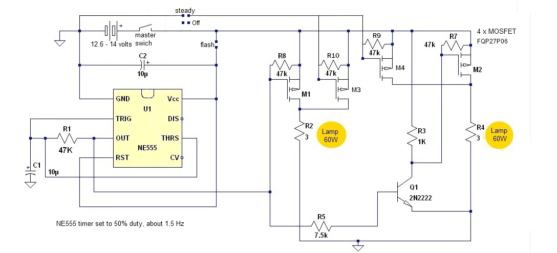

The off the shelf versions for emergency vehicles are expensive and heavy, often in heavy potting. I want solid state.
Req:
12-14 volt DC
Two 60 watt (about 4.5 amp) halogen lights....
Flash about 50-100 fpm (flash per minute).... adjustable rate is good.
I am thinking of a 555 circuit may be? What transistor for switching? NPN, PNP, FET, MOSFET?

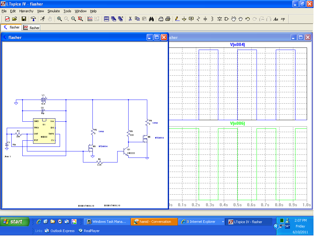

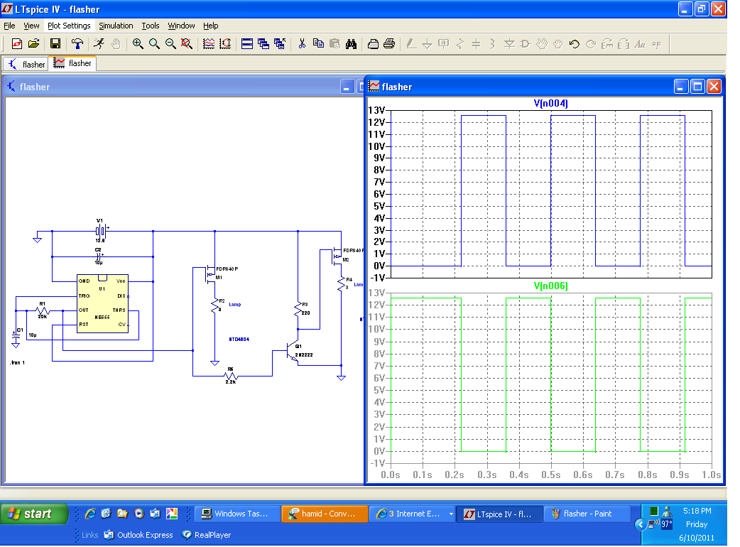

Try this one. Any high power N channel MOSFET will be ok.
Adust R1 or C1 to change the rate.

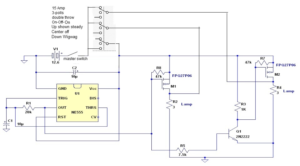

RonV.... perfect thank you, but one issue, I need to switch the POS and not the ground. Is there an easy way to flip that around? Thanks

We can use some P Channel mos fets like this. Get some good for 20 30 amps so you don't need heatsinks.

RonV.... you are the man. I owe you a beer. I will order some parts from Mouser or Digikey and prototype it, should work like a charm.

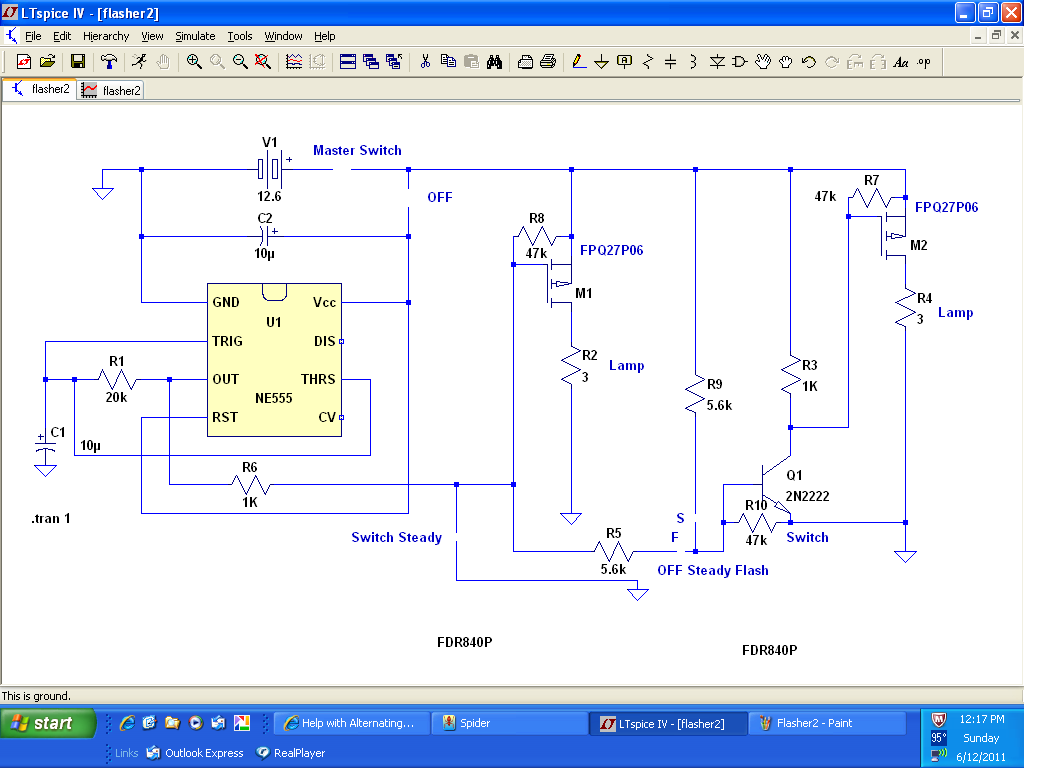

One more twist in the design! What about a switch to go from "WigWag" alternating to both lights Steady? I could do this with a toggle switch. One position wigwag, second switch position for steady (bypass the wigwag flasher). It would be more elegant to use the MOSFET's for steady as well. This would allow me to use a light duty toggle verses a BIG one that can handle 5 amps DC. What do you think?
Flasher
By far the easiest is to use the large switch. I was thinking :rolleyes: while the timer doesn't take much current it is probably a good idea to turn it off when not in use. It will take a 3 pole switch because all the circuits have to be kept separate (3PST center off). I changed a couple of resistors that were to small for 1/4 watt at the same time and added a FET that will work with a small heat-sink. (Mouser 574102B00000G or similar)
Let me know if you want to pursue the small switch, I'm sure we can come up with something.

I really OWE YOU and agree, external triple-pole, double-throw, center-off makes sense. The commercial headlight flash units (the one I am trying to avoid) have all solid state switching, going flash or steady. What do you think of this? See attachment. Not sure about the resistor size. I think I could re-wire the switch so it does not have to take the current.... just current for 555 + gate control.
PS: The FET is a FQP27P06? I'm not 100% on the astable wiring of the 555, but this looks like a simplifed wiring to force 50% duty (which is perfect). The 20K resistor should go to 47K to get about 1.5 Hz? Sound about right.
I like the first one best. It just has high current only thru the master switch. Right you are on the FET. Right you are again on the 555 circuit. This is the simpelist one I've seen to ge 50% duty cycle. 47K is good.

I appreciate your ideas but to explain how the circuit works, I am sure you know, for the record, 2N2222 is "inverting" the signal for the M2 MOSFET. The 555 sends out a positive square wave. This drives M1 OFF, drives Q1 ON, pulls M2 low, drives it ON (and lamp on). The 555 then goes low, reverses the process, drives M1 on, and Q1 and M2 are off. This goes back and forth with the square wave, 50% duty at about 1.5 Hz, each on or off 0.333 seconds, alternating. M3 and M4 just bypasses the WigWag... with solid state switching.
I could forget both M3 & M4 and go with a toggle switch, 3-Polls, double-throw with, On-Off-On. This would be a switch with at least a 15 amp rating. When in steady, it basically bypasses the WIG-WAG module all together. For steady it is just straight through the switch. A switch like this cost about $10-$14. They are wide, ugly and would not fit in with row of single and double poll switches. That is no big deal. I might go that way, to save the current going through the M3 and M$, FQP27P06's. I will get some MOSFET's and see how hot they get at 4.5 amps, no heatsink. I will likely have to have them on the some small heat-sink or greased to the aluminum case it will be in. If they run hot, too much inefficiency, I will skip the M3/M4 and go mechanical switching as plan B.

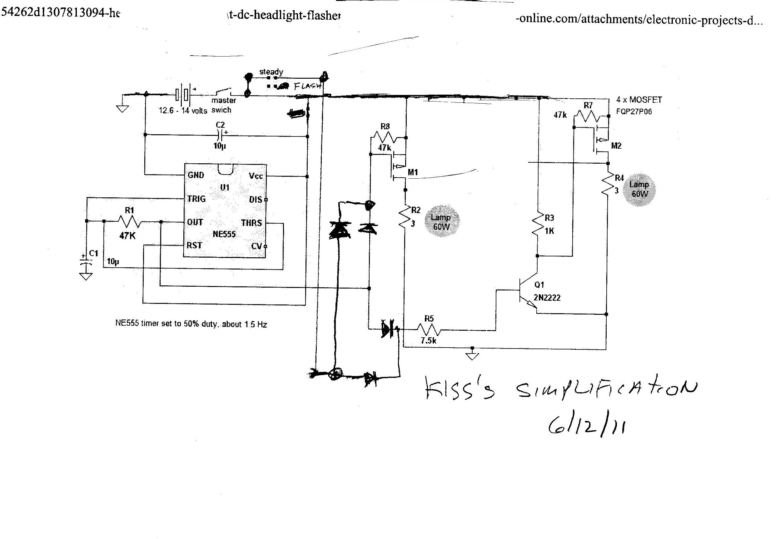

Try the attached version. I just added 4 diodes to your design and cut out the two mosfets.
BTW, I used essentially the 555 design using transistors to build a solid state vibrator for a car radio and I gave a modification of the design to make an inverter for an AC synchonous motor that a co-worker wanted for his telesscope.
The wire-OR technique I used to make a headlight ON alarm. My alarm worked when the Driver's door was opened and the headlights were on. All I needed was a diode in series with a buzzer. Simple with no extra crap.
Getting on the right page with me is sometimes difficult. I'll agree. The CAD program that I really like is too expensive. www.vectorworks.com. Auto CAD sucks. LTspice might not be to bad. Diptrace isn't too bad either. I'm just not fast enough. In Vectorworks it would be cake. I have a couple of other ones, but I don't have any experience with them.
I do hope you agree, that my proposed method is easier. I'll answer some or all of your questions via PM.
KISS
PS: Ignore the lines that seem to go nowhere. Especially the ones on the right.

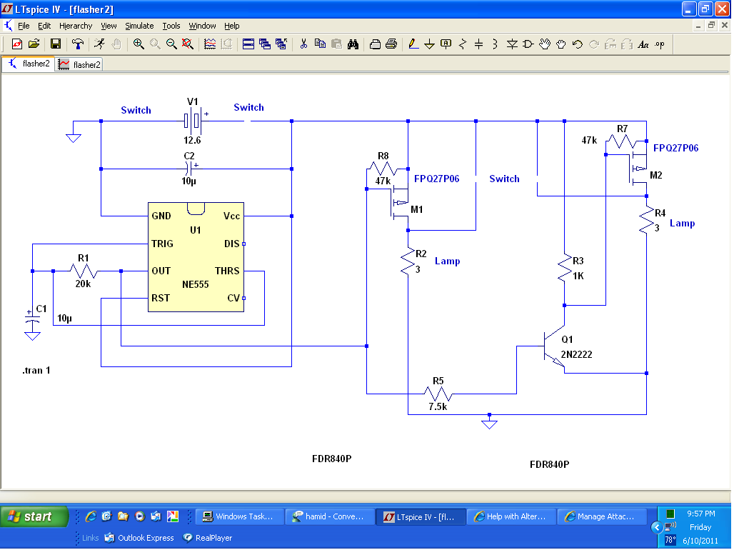

It is a little trickier than it appears on the surface. As a matter of fact the circuit we have will leave the right side light on when the ignition is on but the small switch is in the off position. I thought the master was the light switch.:eek: Soooo, the circuit below will prevent this (No path from the 47k on the left FET to turn on the 2222 a little). Spice shows the 555 output low with no power supplied. I don't think that is correct so I think this will work. 3 pole switch.

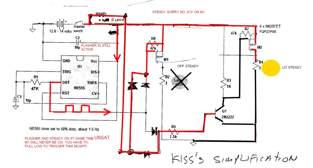

Sorry, I was scratching my head while Kiss posted. The diodes to the left side fet need to be reversed to turn it on with a negative on the gate.
Ahh, the FETs need a negative voltage to turn on. If that's the case then create another driver using a 2n2222 and create an inverter using a 2N2222.

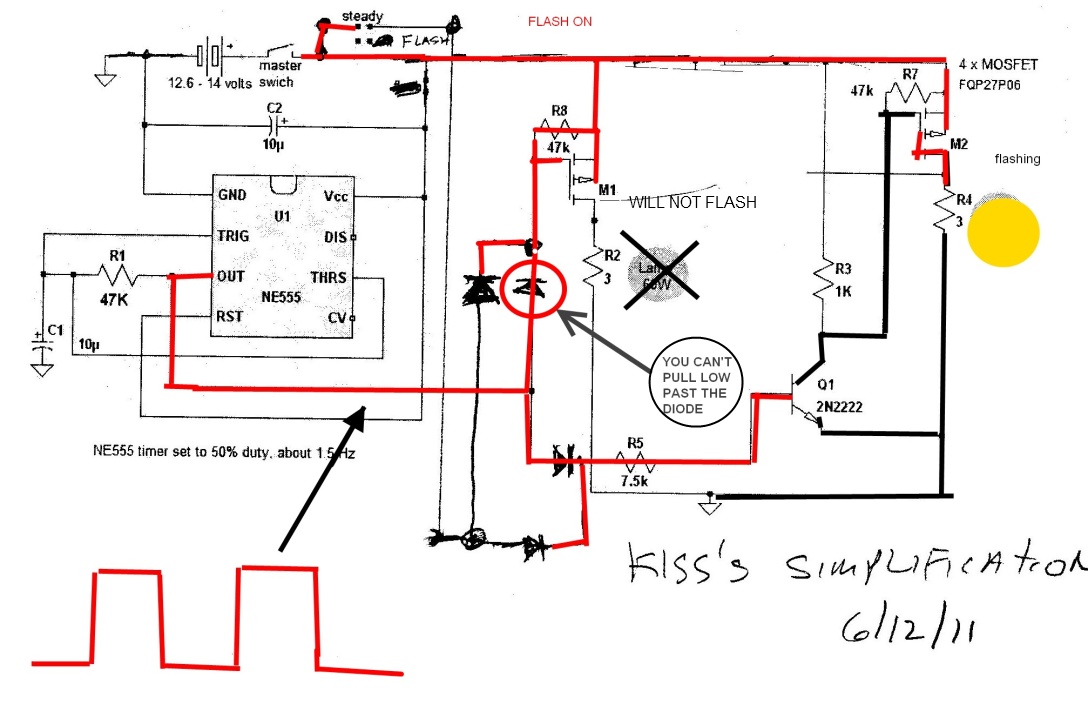

I do hope you agree, that my proposed method is easier. I'll answer some or all of your questions via PM. PS: Ignore the lines that seem to go nowhere. Especially the ones on the right.
That will not work. Remember these are P channels and diodes work one way only.
- In steady M1 will not light ..... M2 works
- In flash M1 will not flash, only M2 flashes
- With steady position flash (555 timer) is still powered, there is no OFF.
(The master is HOT bus power, and flash with steady is not acceptable)
Sorry this is a total fail my friend. You could fix your idea with switch logic, and that would eliminate the need for diodes! See my attachments above with the 3PDT switch. What is wrong with that? Don't answer! That's rhetorical, there is nothing wrong with it, eliminates the two $1.00 transistors you seem to be so against, but you are more than willing to pepper the circuit with FOUR diodes? My basic design doesn't need fixing, it meets the design goal. Your idea does not work at all and still does not simplify anything. Come on man.
Sorry. Nice try! Unless the rules of diodes and MOSFET gates changed, your idea will not work. If you have any questions let me know. Try again and look at my example above; with ONLY two MOSFET's, mechanical switching and NO diodes, I achieve the design.
Also diodes, have switching delay and voltage drop, not desirable here. It would ruin a nice even WigWag, could introduce L to R timing difference. Regardless your design does not work as is at all. Diodes will not work as you drew them KISS. You added 4 diodes and made it not work. No offense.
AGAIN you can NOT tie the two channels which have reverse logic together, even with diodes, to get alternate AND steady flashing in the same circuit. It takes some mechanical or transistor switching! You can NOT tie the LEFT and RIGHT channels (Left and Right) lights together that need both HIGH and LOW signals (opposite) to light. You can make a flip flop so each channel has the same (both positive or neg signal) logic to fire each light. Then diodes night work, but it will not simplify much. As I explained I am partial to the 555 and not a fan of RC or SCR astable multivibrators. Nothing wrong with them, just the 555 is more stable and easy to use. There are ways to do this with out a 555 timer, but not with this base design. All I need is one of these switches, $4.25, eliminates the two transistors (no diodes):
