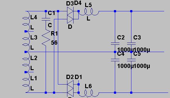

Hi again,
Oh that's nice that you drew that because i think that helps.
From looking at that and assuming that the problem is because of something on the secondary, one thing that is interesting is that if one of the inductors (like L6) went into saturation, that would cause a huge current (or at least greater than the other) to flow into the caps and that could upset the flux in the transformer which would cause all sorts of problems as well as audible noise.
But you are saying that loading the +12v alone is causing a problem by itself, so maybe L5 is saturating. I wonder what happens with only the -12v line loaded?
Where did you obtain L5 and L6? If there is a problem with them then you'll see a similar action.
If you can not determine if they are saturating then you could try swapping them, or you could take them out entirely and replace them with maybe a 2 ohm power resistor (one each side). See if it runs like that.
Alternately, you could disconnect the diodes and connect power resistors across the secondary to test the circuit up to that point. That would tell you if the output circuit is really the culprit or it is really something on the input or the transformer itself.
You would look at the AC signal out of the secondary with it loaded appropriately. A good idea would be to solder the resistors into place for this test so they dont pop off and blow out the switching transistor.
L5 & L5 are a single toroidal inductor with two matched windings connected in opposite directions for the two outputs (I don't know how to 'draw' that on LTspice) It shouldn't saturate when operating within the supplies design current (in theory) as it's part of the original supply - I've just modified it as the original -12v winding was of too-thin a wire so I've rewound it with thicker wire, but the same no. of turns as original.
I can't test the -12v output by itself as the feedback is only on the +12v, so it doesn't react to the increased load on the -ve rail alone.

But now that we've had a chance to talk about this back and forth a bit, the picture is starting to get more and more clear. I think we are narrowing down what might be wrong, although it could take a little more effort in posting back and forth.
The basic circuit looks sound. Everything looks like a typical power supply, except for one thing. That's the "common" inductor. That's something we dont have much information on other than that it came with the power supply and you've added a new winding and removed the old winding. What this means is it would be very hard to figure out what to put in a spice simulation for that object, although every other object we could pretty much guess at what we could do, but even there we dont really need to because the basic circuit is quite simple.
So in this case my recommendation is that you remove the common inductor and replace it with something else, even if just power resistors for now, just for testing. Modifying something like that without knowing all of the effects that mod has on the entire construction is not something we like to do really. Although it seems like it should work there is always the chance that it did not work as expected.
So an idea for troubleshooting would be to remove that inductor for now, replace it with either two known inductors or with two resistors just for now to see if you can get the supply working better. You dont want common inductors on a general purpose power supply anyway.
Even better as a starting point as i said before, run it with just resistors on the output of the transformer, no diodes or chokes. See if it can function with that kind of load first.
Another idea might be that the diodes are different. If one diode has too much more voltage drop it could cause a DC current to flow in the transformer.

Well that test is to eliminate at least one component from the list of things that might be causing the problem. The full AC only output test would be next, which would eliminate the diodes. That will eliminate everything on the secondary side so if the problem persists we'll know it's on the primary side, but if it goes away then it is most likely on the secondary side. One thing though is that you'll have to use some diodes and a resistor and filter cap for the feedback i guess.
The asymmetry is easily caused by an offset DC current in the transformer, but if that turns out to be true then we'd have to find the cause.

My main reason for wanted to eliminate the common mode choke is because he said he modified it, and any modification can come with a mistake somewhere that is hard to figure out at first.
But yes most likely this is a DC primary current problem. We could find this out if the entire secondary circuit was eliminated but yes that is a harder test to perform because we still need proper feedback to get the circuit to try to regulate as it usually does. But if the output diodes are eliminated (and the other stuff because of that) then there's nothing left on the secondary to cause the problem, so it would have to be something on the primary.
One procedure to troubleshoot something like this would be to drive the control circuit with a stable voltage and turn up the main power input (sometimes called the "B+" supply) slowly, a few volts at a time while looking at the output for problems. This doesnt require any feedback as long as the input is kept low enough. Yes, that's not an easy test to do either, but when you tried everything else you have to dig in deeper and use more complicated tests to find out what exactly is wrong. If this was a production line we might even have a test jig set up to test the output transformer, but we dont have that luxury here so we have to design tests to help find out what is wrong and some of those tests may not be easy to do.
Here's the long and the short of the possible primary DC current problem...
If one transistor turns on and it's voltage drop is 1.1v, and the other transistor turns on and it's forward drop is 1.0v, then that puts Vcc-1.1v across the primary during one half cycle and Vcc-1.0v across the primary during the other half cycle, and that means there will be a net DC current flow in the primary.
The actual level depends on the primary resistance, but the primary resistance is usually kept low in power converters to keep efficiency higher. The series capacitor should help here though, if this particular unit actually has that capacitor, so it could very well be unequal secondary loading which could be caused by the diodes having a different voltage drop.

When using a common output inductor for two equal voltages, the number of turns on the core for the two windings need to be exactly the same. The best way to ensure that they match is to wind the two bifilar.
You can almost think of the two windings as two windings on a transformer (which it really is.) Of course, they also need to be phased properly.
The fact that it seems to work better with two independent inductors makes me think you might have a mismatched turn count in the two windings.
An ATX power supply usually has the same inductor for the 5Volt output as well. The turns count of the 5V and 12V windings also has to match the 5:12 ratio.

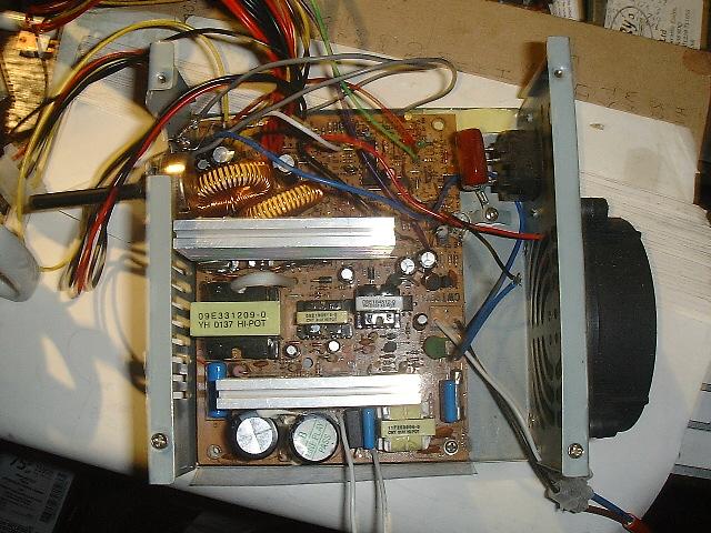

Hey if you feel like posting a few pics so we can see what it looks like it real life that would be nice too.
well you may have to wait a day or two for pics - as I said it's a bit cumbersome with my old camera - but I'll try.

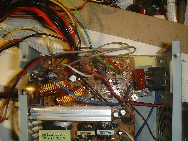

Well it took a bit more than a couple of days but here are the pics.
It works in constant volts (25 - 29.5 - using the pot on the left side) or constant power (rather that CC) as I simply modded the overload 'trip' to limit the output (adjustable using the silver trimmer hanging off the edge of the board - currently set to 7A at 29v).
I've not yet added the extra caps or the input voltage sensing (work again).
Yes there is a surge limiting thermistor.
