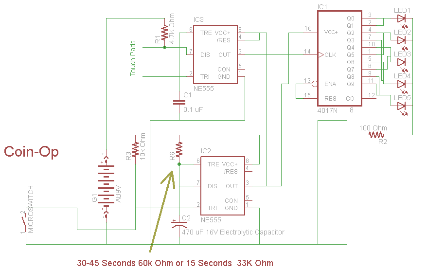

I am trying to make my own coin op machines. I am new to electronics and this is a bit harder for me. The big problem I have is having a circuit timed to stop after turning on as well as accepting money. I had a friend make a schematic of one and I am not sure it will work I think he misunderstood me. I am looking to do a couple of different things. I was wondering if a momentary switch would work or one of those little push button type things and have the coin directed to fall on it or a attached thing to hit it to start. Then the other problem is time. The schematic he made should give me a set time but for some other ones I want to make I wondered if I could use a timer schematic from a 555 using a pot. and add to the rest of the schematic to make the thing work but for a certain duration when it was turned on.

I have attached my schematic for a love tester machine my friend helped make it should have the time part solved but turning on and off from a coin he used a microswitch and not sure if that is right. If it is let me know. I still have some other things I want to make too which will need help with a timer of some kind.

At first glance it looks good. You get it to start by having a coin fall on the microswitch and quickly roll off. Your friend already pointed out R6 as where to adjust for time. It already stops by itself, and you restart it by dropping a coin on the microswitch.
2 things...9 volt batteries don't like driving 5 LEDs at once. You might want to put 2 or 3 in parallel. When you put a potentiometer in the R6 position, keep a "minimum time" resistor in place or you'll smoke the chip.
I was not going to use a battery I want this plugged into the wall. This schematic I am not worried about the timer part but some other ideas I am thinking of using a timer. Maybe I should ask for help on this schematic and then ask help on the other idea later. But you think this would then work with a microswtich to turn it on and then once it was one it would turn off after the time and then when another coin droped to start the microswitch it would og on again?

1)2)3)google 555timer circuits, you need to use a one shot circuit to start it up and turn off after time(it will wait for NEXT)
THats what IC2 is doing in your friends circuit, adjusting R6 & C2 will change your "on" time line, there are lots of online calculators

Does the IC3 thing work? It is an astable setup, right? I don't see a resistor between pin 6/2 and 7. Maybe it doesn't matter.
Also I see "Touch pads." Is this just using a part of the body to make the connection that makes IC3 operate? Does it work well?
Does using IC2 (555) as a power supply for 2 other chips work well? I've always tried to avoid that. But if it works - Fancy can wait on that too.
