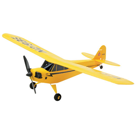

One of my new electric RC airplanes weighs 0.88oz (26 grams) complete with power battery and flies only about 10mph (16kmph). I can run faster when there is no wind and frequenctly it hovers when there is a light breeze. It can climb so high that I can barely see it.
Hawks chase it around the sky but it can fly loops around a hawk.

Uncle $crooge; Nice plane, has it ever been attacked?
Andy
Yes.
Hawks chased my Piper Cub airplane through the skies a few times and one time took a bite out of it.
My P-51 Mustang 2nd world war airplane is about the same small size, weighs a little more because it has an additional servo for the ailerons and flies faster than a hawk.
My friends and I fly circles around each other in the park. We haven't collided yet.
The Li-Po battery cell that powers the airplanes for about 10 and 15 minutes weighs only 3.4 or 4.1 grams.

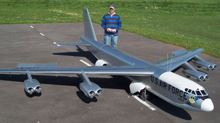

My RC airplanes are quiet and are smaller than hawks so they think my airplanes are something to eat.
There is a video on the internet of a huge model B-52 bomber with 8 model jet turbine engines (they are deafening). Each engine costs $5000. A second video shows it crashing.

On the RC front... love that video of the B-52 crashing. If you want to see pictures and video of the racing we do you'll have to google "central utah pylon racing" (this is the link that I think is keeping my posts from posting). You can also see the clock in question in the header graphic of our web page.
