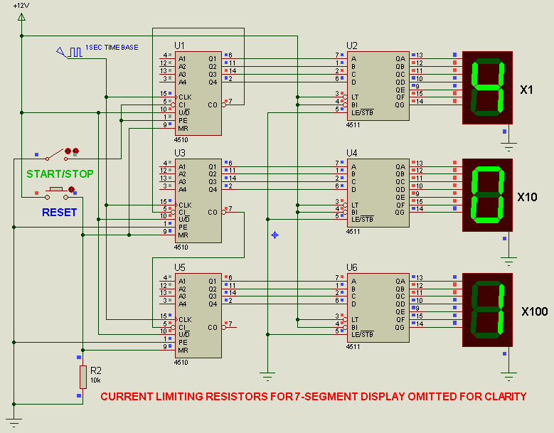

Hi jc1ortiz,
if you don't like to dig into microcontrollers here is a timer circuit using discretes.
For a one-second-time base you might salvage a crystal operated clock (kitchen clock) and use the output signal adapting the signal level for CMOS logic level using a switching transistor.
The image shows the circuit at a count of 104 seconds.
To start and stop the clock you might use a simple light barrier with latching output.
Boncuk
