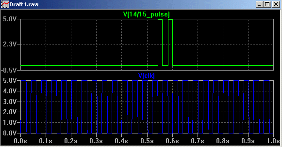

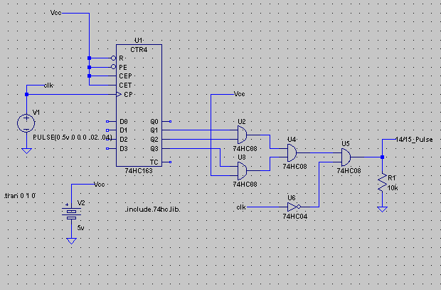

If I follow what your doing, your trying to make a pulse for count 14 and a pulse for count 15. If so, try this configuration. Simulation and schema attached.
You almost got it, I want the 4-bit binary counters to count to (1110)15 then give a pulse, and (1111)16 then give a pulse.
Out of demux it would be outputs o14 and o15, since output start at o0.
But can something be done using less IC?
Diodes, resistors and such would be perfect, as they do not count as IC.
At last resort I can replace the demux with another IC, like the quad AND.
Thank in advance!
The cap and resistor is the cheap and dirty method. Mike has the clean implementation. I just ran the simulation at the higher speed so you could see the transistions.
