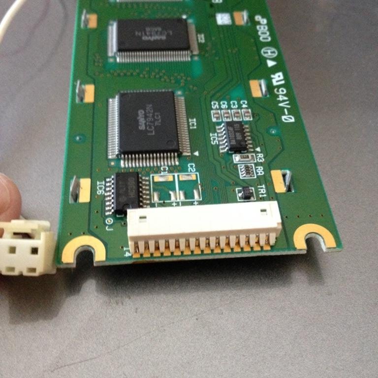

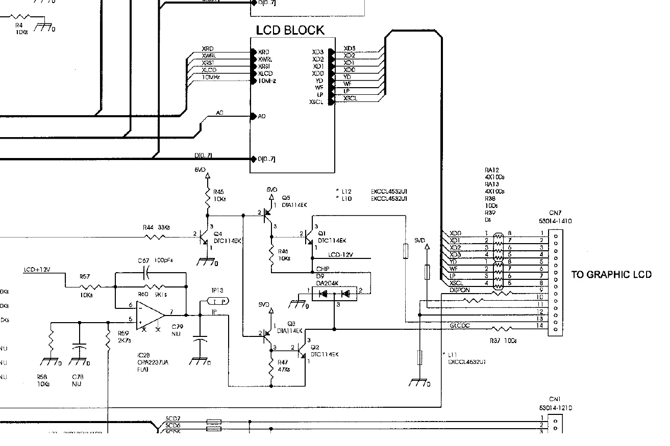

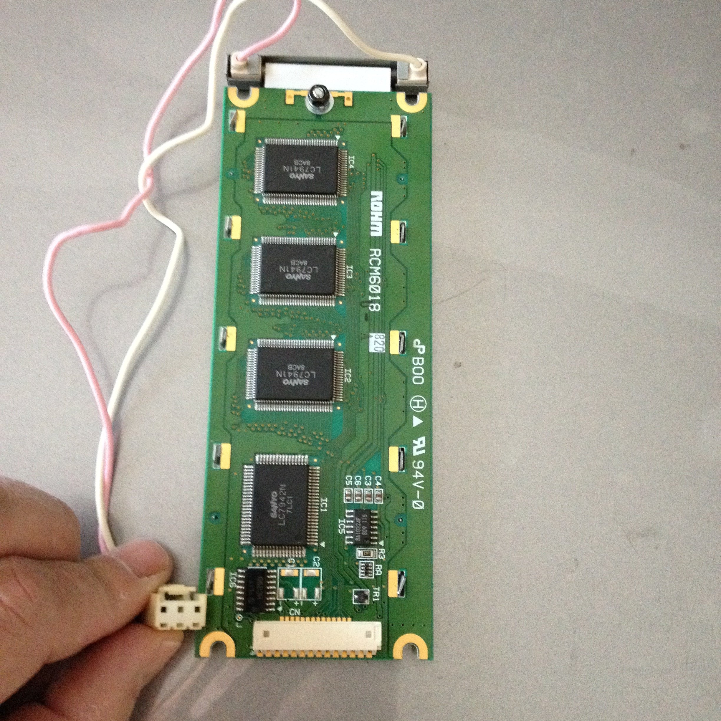

I aattached more photos and the diagram

The unit displys the problema is only with the display has alot of white áreas and lines.
The back lights work
I send some photos

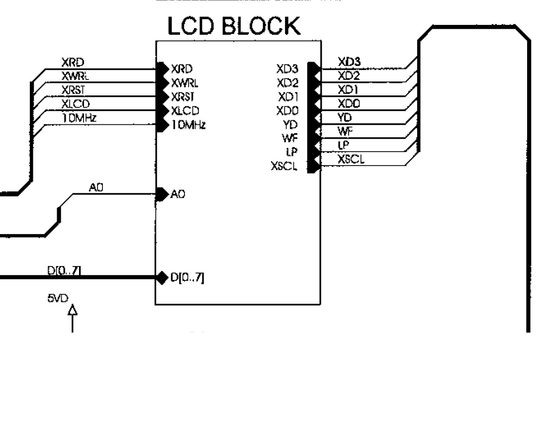

After studying your schematic it seems like the controller is not on the graphic display..
The chip labelled "LCD BLOCK" can you tell me what written on it!!
As this chip has the RD,WR, RST and CD + the data bus... It may be possible to hook a normal display to these pins.
This depends on the controller chip!!

Same here! If it were mine I would try connecting the display to the other side of the LCD block. Risky if you don't know what you are doing..
