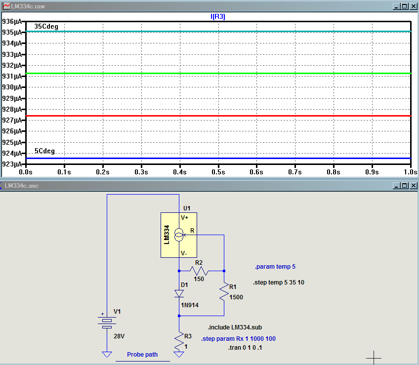

hi Chris,
This what I get from the LTS simulation for the LM334.
I have stepped the probe path from 1000R to 1R and the current is close to 0.9mA for these loads.
Can you post a sketch showing how you have the components connected.?

hi Chris,

I defined Rx the 'load' as a {Rx} variable in LTS and then the LTS directive .step param Rx 1000 1 100.
This runs the runs a plot of Rx from 1000R to 1R in 100R steps.
OK.?

Chris,
For ref I have run the sim for temperatures from 5C thru 35C, looks OK.

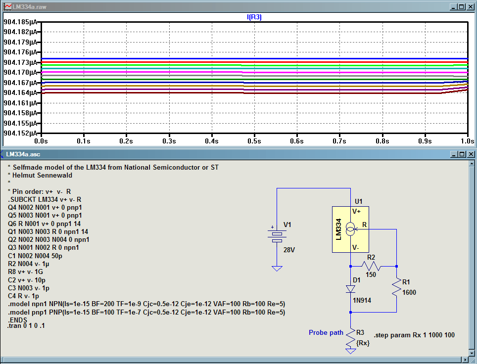

I've installed this LTSpice and replicated my circuit there,
and my simulation is nearly identical to yours.
