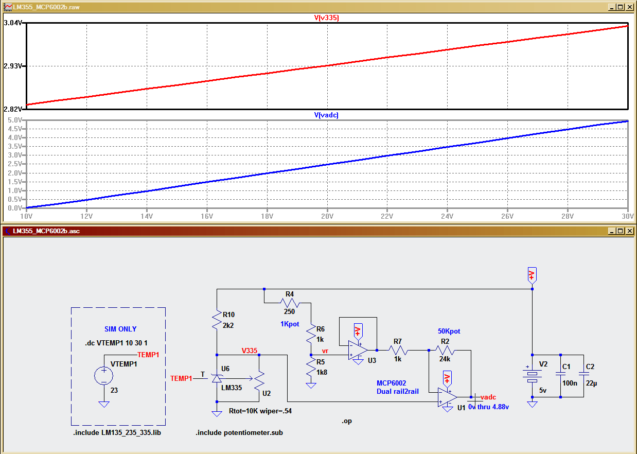

Hi all,
I know enough about electronics to identify components, solder a PCB and use a multimeter...... I have a Velleman K8055 USB board that I am trying to connect an LM335Z to. I don't care about temperature accuracy just resolution as I wish only to monitor relative temperature changes over a period of time.
Based on the LM335 data sheet, the temperature range I am interested in (10-30C) will output 2.83v-3.03v. I need to increase the resolution of this range to max (0v-5v). Now from what I have read (based on my limited understanding) I will need an Op-amp but have no idea how to design such a circuit.

This is a typical level shift and amplify for a LM335 tempr sensor.
If you scale the SPAN to give a Vmax of 4.88V at the PIC adc input, this will correspond to 1000adc counts for a 20Cdeg change, makes the maths easier.
NOTE: the MCP6002 rail to rail OPA, powered from +5V.

The K8055 does have adc inputs, but by using the built in Vref of 5V, how can the PIC increase the resolution of a 0.2V signal,
For example a 0.2V change works out at [0.2/5]/1023 which is only 41 adc counts, thats only 0.5C/bit.
If the OP raises the 0.2V to say 5v thats ~1000 counts which gives a resolution 0f 0.02C/bit.

You have not read fully what the OP is asking.
He has Velleman USB pcb, which has an onboard two adc inputs to the PIC.
He wants to increase the resolution of a short section of an external LM335's range, if it was your project you could choose the accept the existing resolution and use a Picaxe, but he has asked how to use an OPA to increase the resolution/Span, using the Velleman pcb, this is exactly what I have posted.
