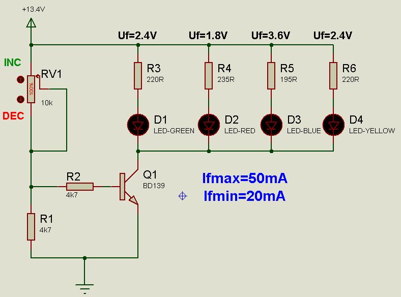

Here's a simple circuit to dim the LEDs between 20 and 50mA. The LED current limiting resistors are calculated on the basis of UB=13.4V and the LED forward voltages (Uf) as given in the schematic.
Since the warning lights of the motorbyce may be wired a similar way as they are in cars you just have to open the ground connection and put the transistor between chassis (ground) and the LED cathodes.

Thanks Boncuk
I appreciate the diagram. Each of my warning lights will have its own live feed, they are warning lights rather then instrument illumination lights, ie turn signal indicator, engine check light, high beam, etc so I'm not sure how I would need to change to diagram?

Hi Stu,
you just wire the LEDs like the lamps were wired with the exception of a current limiting resistor in the positive rail and an NPN-transistor in the ground rail.
All LEDs in the schematic are connected to +UB. Switches (like low/high beam switch) supply +UB for the control light. Just use that output for the control indicator LED and leave the cathode like it is in the schematic.
To dim the LEDs I suggest to use a sliding potentiometer mounted in a small metal enclosure (spray water tight). Using a slider you might use the thumb for convenient operation.

The max allowed continuous current for the LEDs (not in hot sunshine) is 50mA.
The "recommended" 100 ohm resistors provide a current of 110mA. Each resistor dissipates 1.2W.
