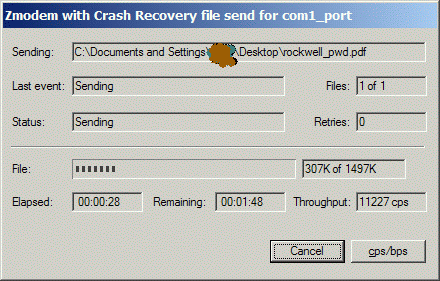

ok, just to prove it, i decided to use generic el-cheapo converter with Prolific chip, two PCs and crossover cable (Allen Bradley 1747-CP3).
the other pc was also D800 Dell laptop using similar converter.
(Dell D800 comes with built in port too).
port setting 115kbps (if you want i'll test with higher too), 8-bit, no parity, no handhake. sample file was PDF document about recovering password from AB PLCs (SLC series). file is 1,540,096 bytes or close to 1.5Mb.
sustained transfer rate was just over 11200 characters per second. transfer was complete in about two minutes.
edit:
the screenshot is using COM5 but i named it com1_port while
setting up HyperTerminals....
note that first 300kb was transfered in under 30second which
also indicates more than 10kb/s
