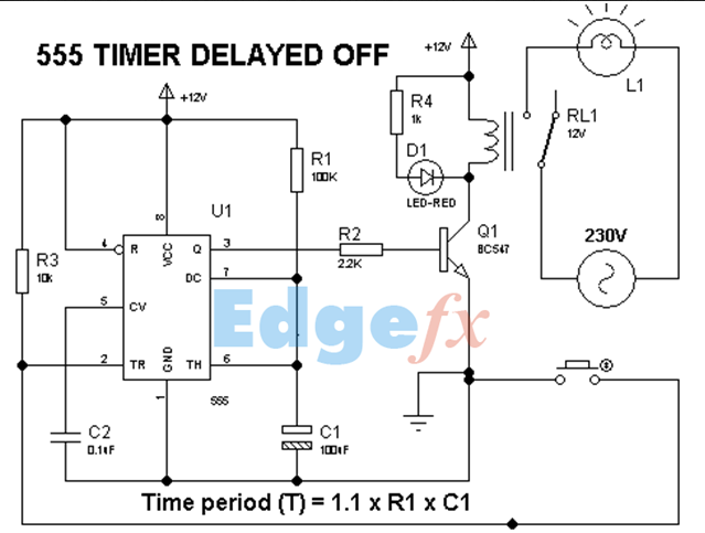

Hi, I'm having trouble with the following and help is appreciated:
I'm automating a very very simple irrigation system without a micro, instead I used a monostable circuit with a NE555 so that the irrigation would take place once a day. My monostable circuit needs a single pulse that is given by a push button to trigger a relay for 14 seconds, but I would like to use the positive transition given by a wall mounted AC timer to trigger my monostable circuit. The timer will be on for 12 hours before completing the pulse and turning off.
The circuit I used is in the attachment

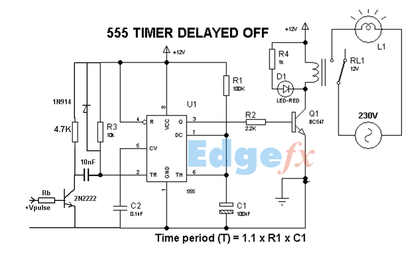

Add the components as shown on this image.
Let me know the details of the positive input transition and will work out the value of Rb on the transistor input.
E.

Hi.
The positive transition comes from the wall mounted 120V AC timer and then switched to a 12V DC grounded transition through a relay.**broken link removed**
The image shows kind of what I would like to accomplish; to use the transition of the 120V timer to activate the 555, the problem is that I need to find a way to interrupt the transition from the wall mounted timer so it gives me a complete pulse.
Hope I've explained myself well, if you have any question please do make them. Thank you in advanced!

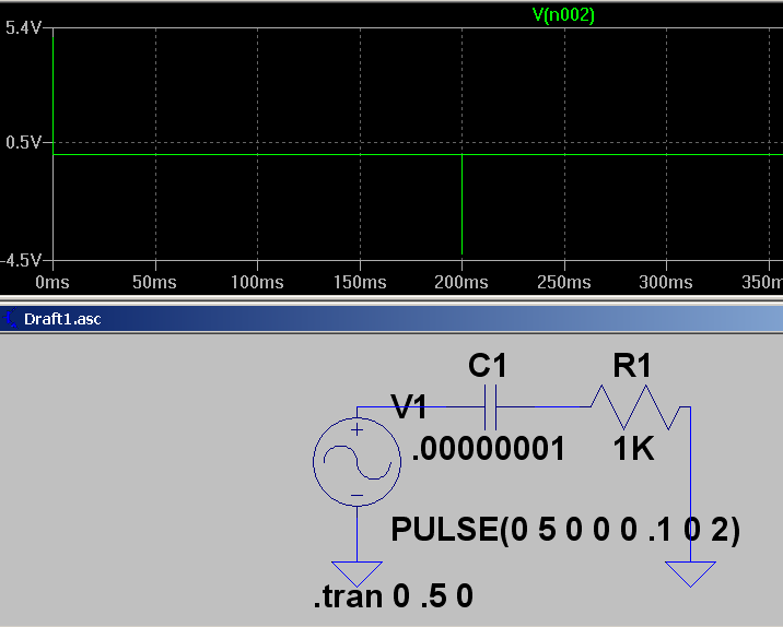

If you apply a positive pulse to a capacitor, won't you get a negative pulse on the other terminal which should be enough to trigger a 555?
View attachment Draft1.asc
John
Here's a screen print,in case the asc doesn't work.

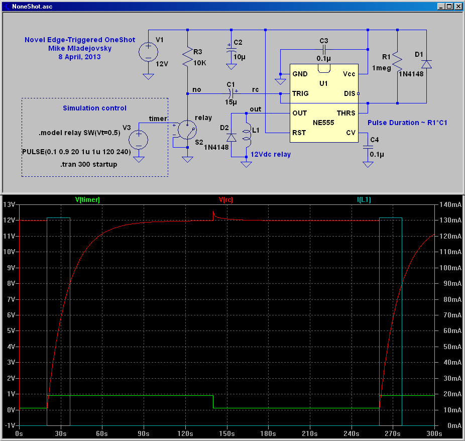

Here is a hack at what I think you asked for:
In the process I think I came up with a novel way of using a 555 as a positive-edge-triggered one-shot. Never built it, but am confident it will work as simulated.
In the simulation, the signal V(timer) [Green Trace] is a proxy for what the AC wall-clock timer does, except for convenience I made it be on for 120s and off for 120s instead of 12h and 12h, respectively. I'm assuming that the AC wall-clock timer controls a relay, which provides a contact closure as long as the AC wall-clock timer output is on.
That NO contact is shown as "S2" and "relay" in the schematic. It switches the left end of the timing capacitor C1 to ground while the AC wall-clock timer output is on, triggering the 555, initiating the timing cycle of 15sec as shown by V(rc) [Red Trace], and pulling-in the 555 output relay as shown by I(L1) [Blue Trace]. When the AC wall-clock timer relay turns off, diode D1 clamps the voltage at node "rc" one diode drop above Vcc.
Note that as long as the AC wall-clock timer duration is at least 15s, then it doesn't matter how long the duration is, even if it lasts 12h. The 555 output pulse duration is slightly longer than R1*C1.
C2, C3 and C4 are required bypass caps. D2 is a snubber for the output relay. As mentioned earlier, S2 is the NO contact controlled by the external 12h timer.
