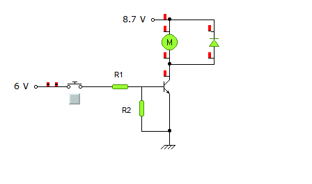

I need a some help trying to get a motor working by switching it on through a more powerful battery. I havent actually done any electronics in a good 3 years and I wasn't very good at the higher power stuff anyway!
Basically I have a circuit that looks something like the one attached and I have a couple of MOSFETS and various high power transistors lying around, can some one help me with the calculations required for R1 and R2 and what sort of parameters would be good for the MOSFET/transistor?
I know the motor usually runs on 8.7v and draws around 2amps. If possible i would also like to reduce the draw of the motor and reduce its RPM, can that be done?
The most power-efficient switching device would be an N-channel MOSFET. It should be rated for at least 20V, 20A, have a low Rds(on) (<50mΩ) and be a logic-level type (since you are using only 6V to drive it). R1 could then be 100Ω (for damping any spurious oscillation) and R2 could be, say, 10k. The motor would need the freewheeling diode connected across it (as shown) and perhaps a snubber.

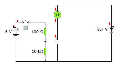

So I've followed your advice and should I be building something like what I've attached? It seems a little unusual for me to have the two ground rails the same but otherwise how can I link the Gate resistor to the Source while still having a complete circuit for the Gate to go high (in this example)?
Your circuit has only one ground rail (to which the -ve terminals of both batteries are attached), but is missing the essential freewheeling diode. If you have built this on a breadboard then it's not surprising you get erratic results; stray inductance/capacitance can cause FET oscillation and poor contacts/connections probably won't allow peak currents of ~10A at motor start-up to flow without problems.
Ok I will take it out of the breadboard then and also I've realised the diode I have is actually a zener diode, is this any good for these purposes?
Not if the Vz voltage is less than the motor supply voltage. Even so, the Zener is not likely to like the 2A or so that flows through the snubber diode just as the FET turns off. See if you can get a 1A to 3A rectifier diode with a PIV rating of 100V or more.
