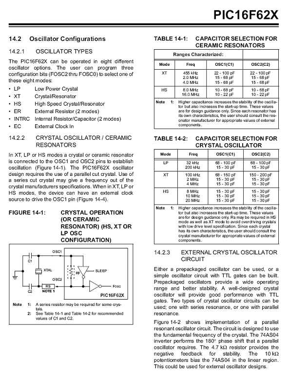

Hi mike,
I am breadboarding, so I programed my PIC and then set it up with the crystal. I tried using 22pF caps, because that was all I had got, and it didn't work.
Would this make sense??
Are the caps just too low??
Cheers,
Fred
Hi Fred,
The caps may be too low or it may be something else, can you put 2 caps in parallel on each leg of the crystal? Did you change the config to LP from XT? What are you using to program your chip? Are you sure it is being programmed?
Hi Mike,
I could put 2 caps on each leg of the crystal if i had them! I will have to get some new caps! I converted the assembler file to hex using MPASMWIN and then programmed the PIC with Progpic2.

Hi eng1,
The picture attached is a circuit diagram for how to connect the crystal to the PIC. Then all you need to do is to connect the power lines to the PIC and a cable out of RB0 for the pulse.
Fred
Fred
With MCLR enabled in the configuration fuses, you need to connect pin 4 to Vdd with a resistor, 1 kohms should be ok. Or disable the external MCLR funtion by changing the config settings: _MCLR_OFF
