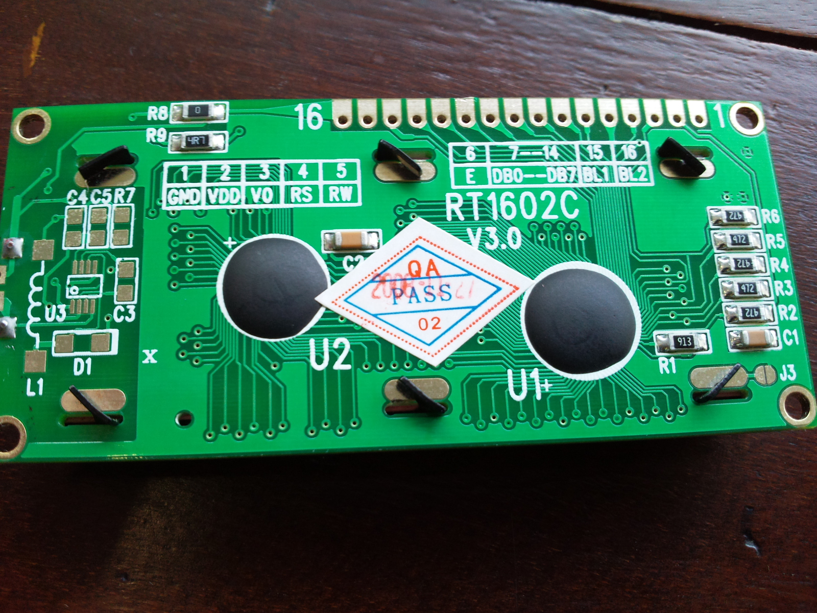

hi to all. this is my code for using BS2 a PPI 8255 to control a LCD
as im quite new, im not sure which part of my program went wrong
the attached files are my 8255 datasheet and LCD
can any one tell me whats wrong with my initialization?

do you have any recommendations?
i need to use a keypad to output to the LCD, then wireless transmit the info enter from the keypad to another board
Why not use a second BS2?, or any PIC - all the antique PIO chips are intended for micro-processors not micro-controllers. The 6522 (the 6502 PIO) was a vastly superior chip to the 8255 though.
Or why not use a simple logic IC?, there are various schemes use a couple of pins to feed a TTL or CMOS chip and feeding an LCD.
Also if its a 'pin' shortage problem, why use 8 pins for the LCD data, send the data as two 4 bit nibbles, that will free up 4 PIC pins.

You can get a 82C55 [cmos version] of the PIO.
You're using 15 pins with an 8255. I normally interface an LCD and a 4x4 keypad using just 11 pins.
4 data pins to LCD and keypad columns via blocking diodes.
4 to keypad rows.
plus RS, R/W and EN to LCD.
You are actually using more pins with the 8255 than you would without it. Plus without the 8255 your code would be much simpler.

You've used 14 I/O lines to connect to the 8255
You could drop the 8255 and connect the LCD & 4x4 keypad to only 10 I/O lines
4 to LCD D4..D7 and the keypad rows
4 to keypad columns
1 RS
1 E
GND RW

If you wrote the code to interface to an 8255 then you should have no problem interfacing to an LCD and keypad. If you found the code on the internet then stay with it, as you won't get any help from me.
I can't find a problem with your initialization, but I just briefly looked over it. If you've double/triple checked everything, it's time to hook up a logic analyzer and verify the connecting signals are correct. You're school should have one. If not, you might try a dual-trace scope to observe critical signals, or make a simple logic analyzer using LED's and single step your program. I can't remember if BS allows single stepping, but you can program it and use your keypad as a step commander.
