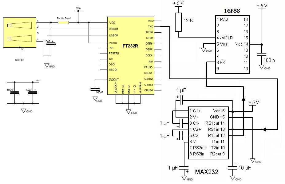

Hello,
I have this circuit attached below and I can open hyperterm and hold the tx and rx of the FT232 and verify I am sending characters but when I try to get my PIC to read that character it does not see it.
Does anything look wrong with my circuit?

EDIT:
I didn't need the MAX232 just the FT232 and all I was missing was the ground from the FT232 needed to be tied into the Ground of the PIC circuit because the FT232 is powered from the USB and the PIC is powered externally.
