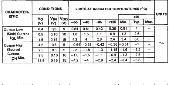

I found relays drawing 28mA, but the 4043 can't handle that directly?
No.
As shown from the data sheet below, the output is only 1 mA typical for a 5V supply.
You can use the ULN2803 or a 2N7000 MOSFET as a driver for the relay.
The MOSFET will also require a diode for inductive transient suppression from the relay coil.
The ULN2803 has that diode built-in.

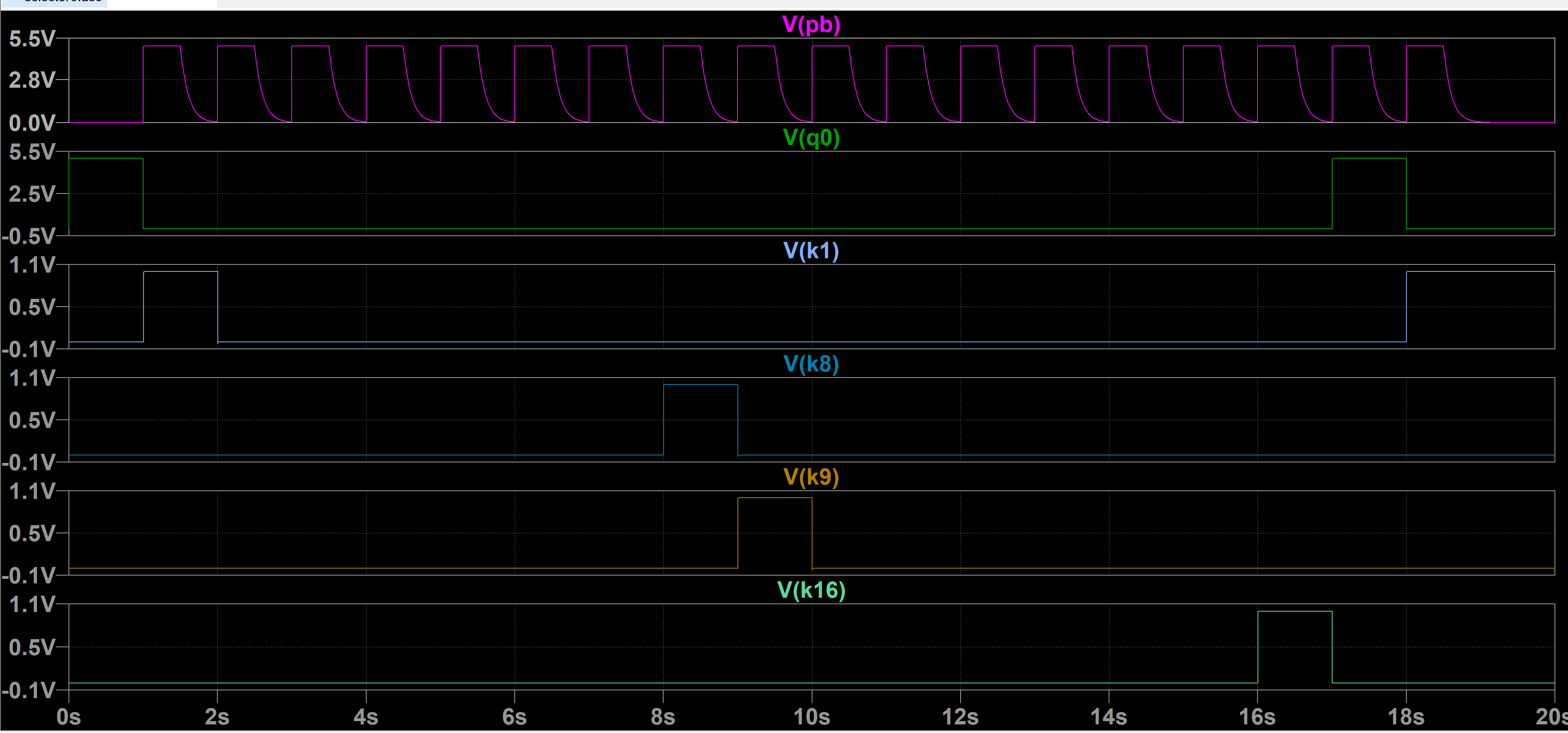

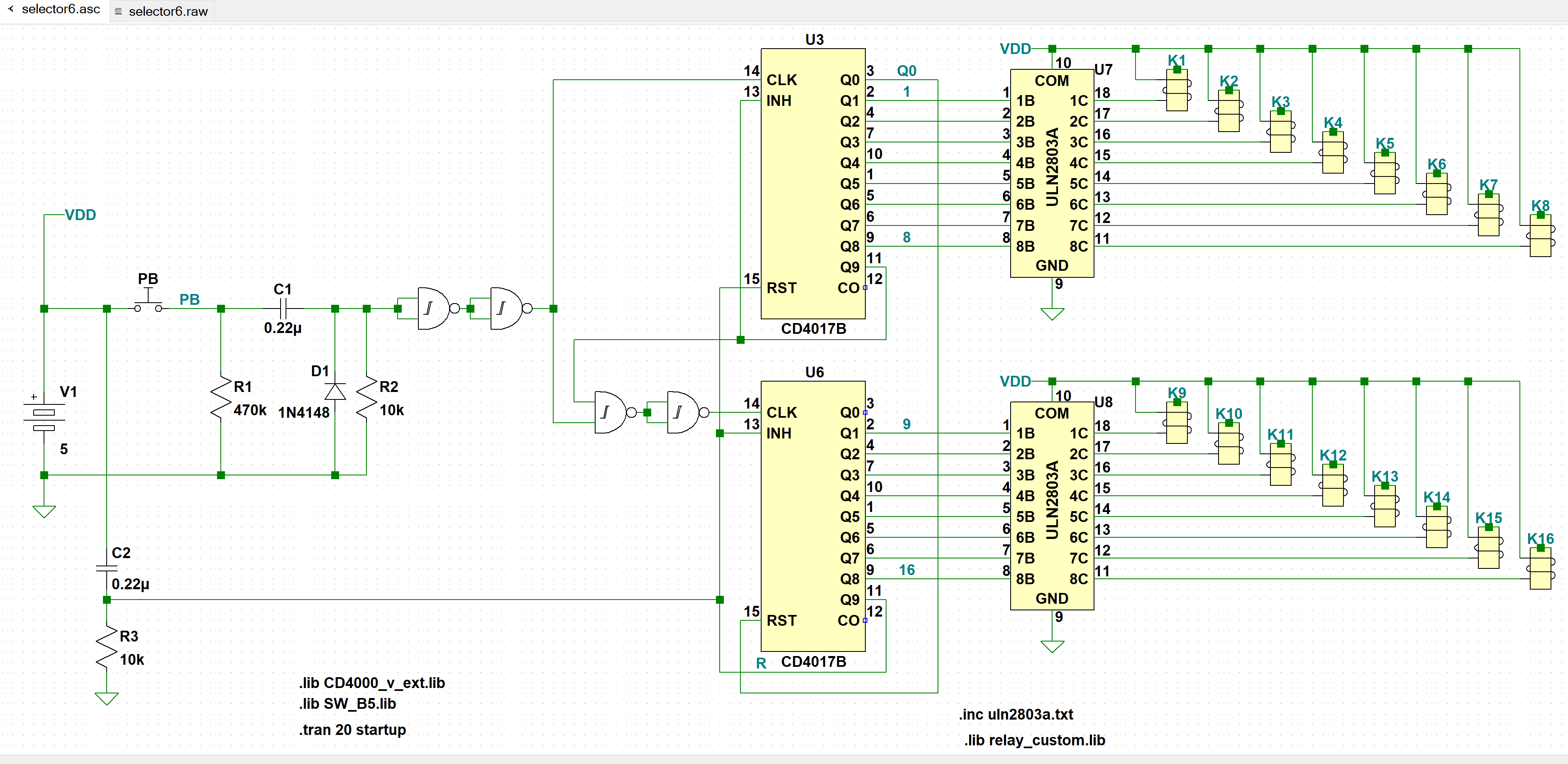

Here's another version using CD4017B's.
The circuit powers up with all relays deenergized.
The 1v,0V level on the graph represents the energized, de-enegized state of each K1,K8,K9,K16 relay, respectively.

Here's an LTspice simulation of the NAND gate circuit with write-up here.
Only the output with the last pressed switch is active.
Each output, with an added transistor driver, or a driver IC such as the ULN2803, can control a relay.
The circuit can be extended to 16 outputs by duplicating the right portion of the circuit consisting of a diode, two resistors, and two NAND gates.

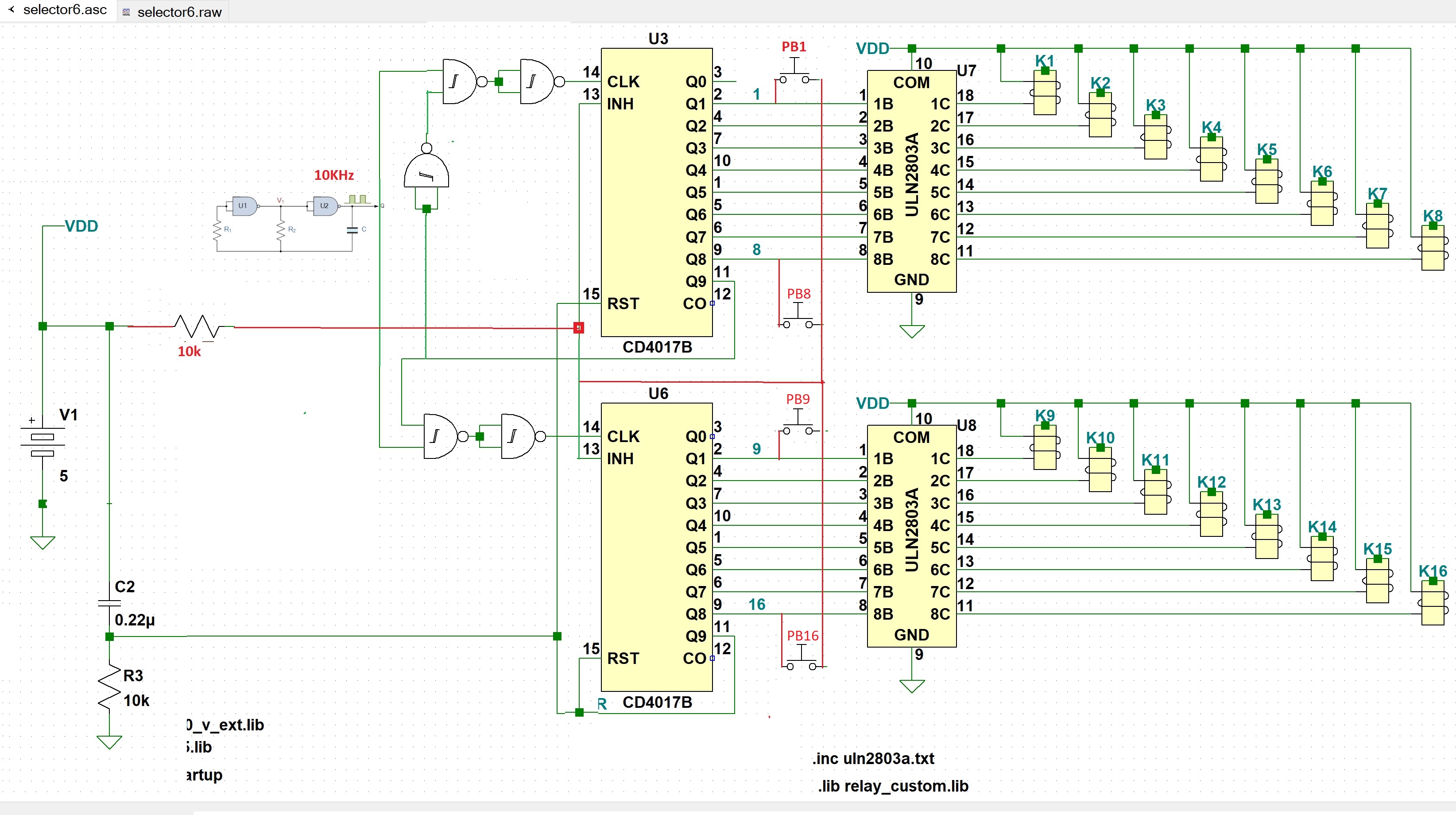

This may work with 4017 for 16 switches selectable. Every time there will be a very short duration pulse passing through the outputs, may not change the status. otherwise it may need a RC / RL delay. Hope replays' mechanical response time will do that. just sketched over Tom's schematic.
Edit: may need some improvement
