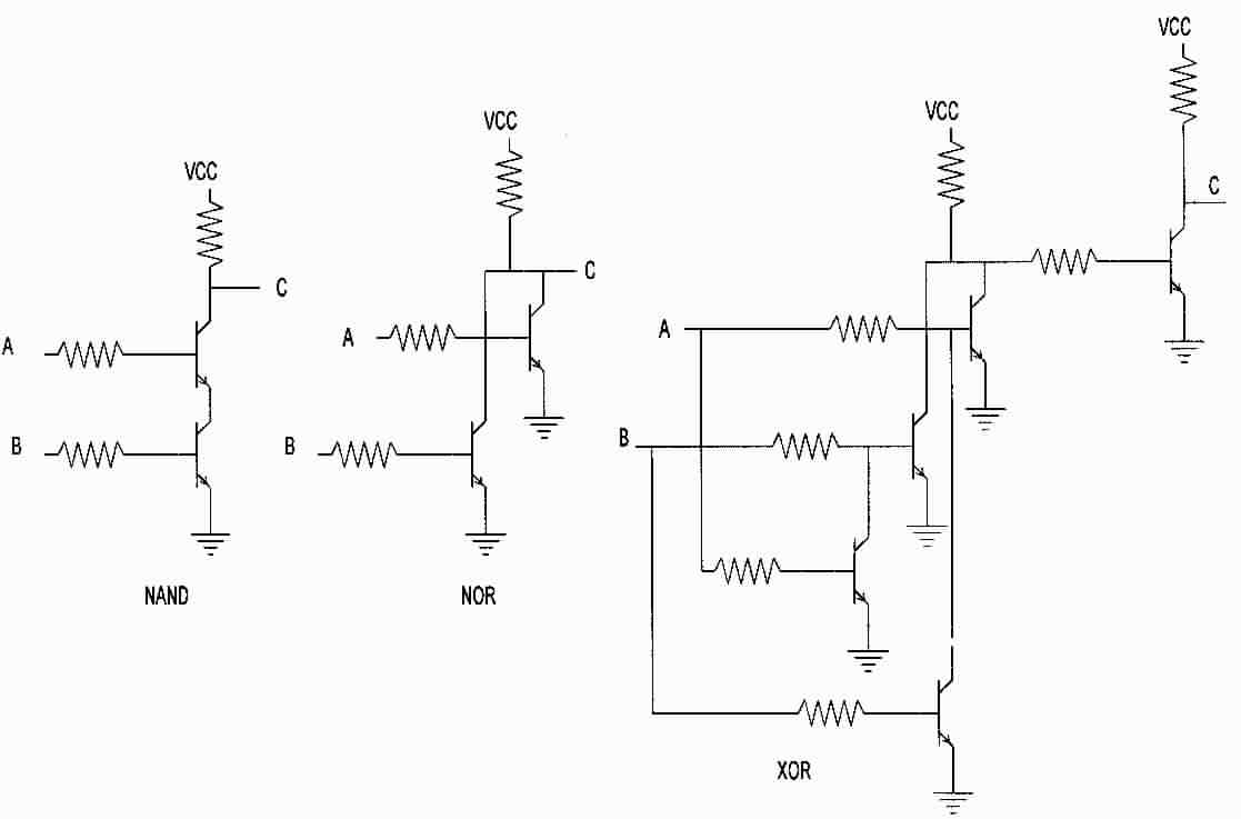

This is my anolagy for the gates:
A and B are the input to the descrete logic
C is the output
Also altough you asked fo r NAND,NOR,XOR the simplest gate AND and OR can be made from two diodes and a resistor - although can only have a fanout of 1

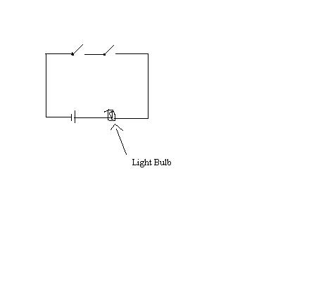

I wz wonderin if u cud gimme a analogy in the form of a circuit that is attached.
The circuit you attached is an AND gate using switches. If you label the switches A and B, then the lamp glows when A AND B are closed.

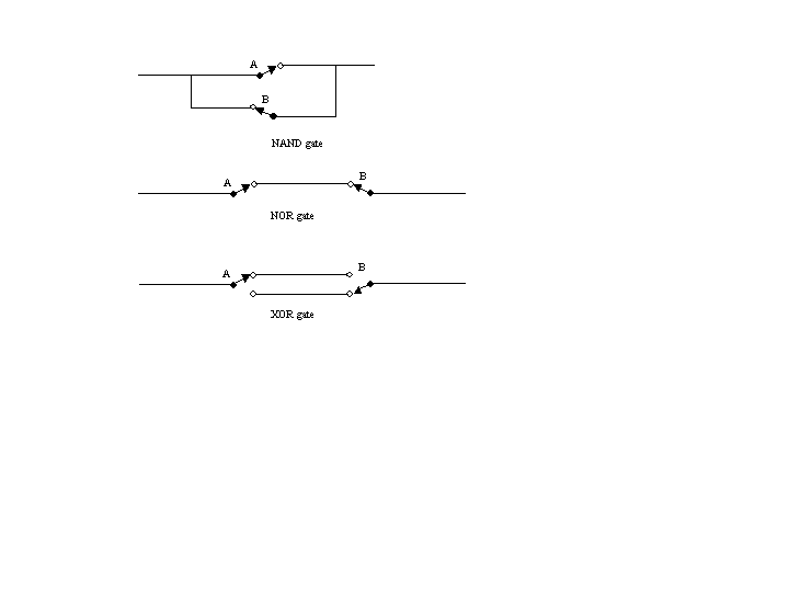

umer007 said:
Yes i know but i need NAND, NOR, EXOR in that kind of drawing. Plz post if u know.
I think you posted this while I was editing my previous post to describe a NAND analogue.
A NOR analogue would be 2 NC contacts in series. So the lamp does NOT glow if A OR B is operated.
I'll draw a XOR and post is shortly.
Len
Here are a NAND, NOR and XOR gate. I'll leave you to draw the lamp and battery.
NAND - lamp does NOT glow if A AND B are operated
NOR - lamp does NOT glow if A OR B are operated
In the XOR case, the lamp glows when A is operated or when B is operated but NOT if both are operated.
This is how lights in houses can be controlled by 2 switches.
