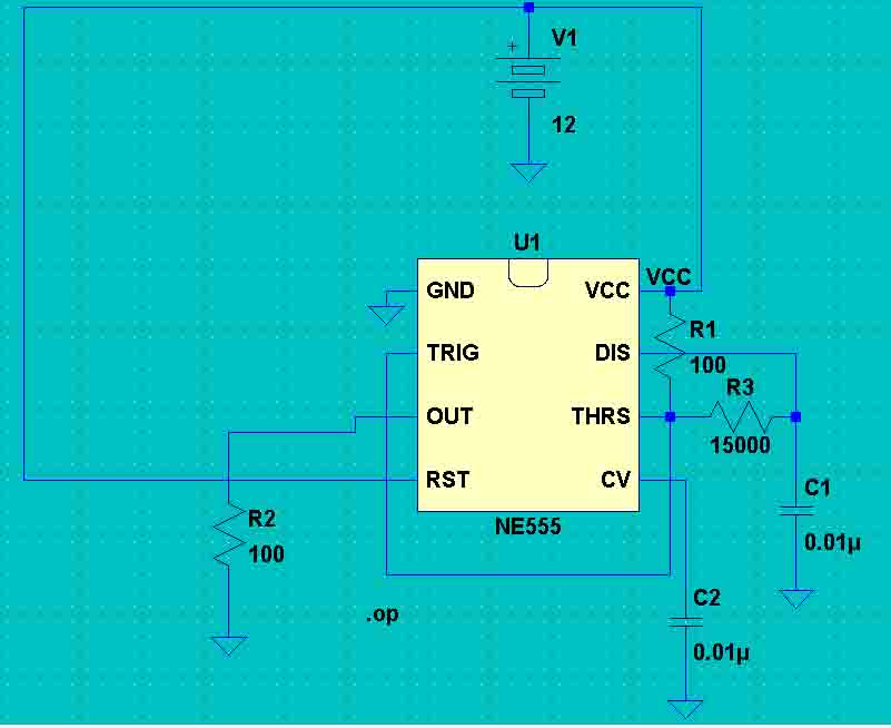

so i've downloaded the above mentioned program and tried to build the circuit that i ncloe a jpg of but when i try and run it all i get is a list of values on all nodes as if it were a static circuit and this appears in a seperate window. i see a graph tab but this window prevents me clicking on it and when i close the window the tab disaperes. is it that i do not know how to use the program it can't do what i want or i have made a mistake :lol:

.OP causes the simulator to find the DC operating point. You need to run a transient simulation. It will be easier to probe the nodes if you label all nodes that you want to probe before you run the sim.

yes i am refeing to tha software and what can i do simpler than that. afraid i am used to the very simple electronics work bench but that was old and won't run on XP. how do i label a node. i noticed that thre i this "method" of reference but cannot find how to open them or do place a net ?

Have you searched for "label" in the help file?
To change from ".OP" to ".TRAN", right=click on the ".OP" directive. A dialog box will open which allows you several simulation choices.
