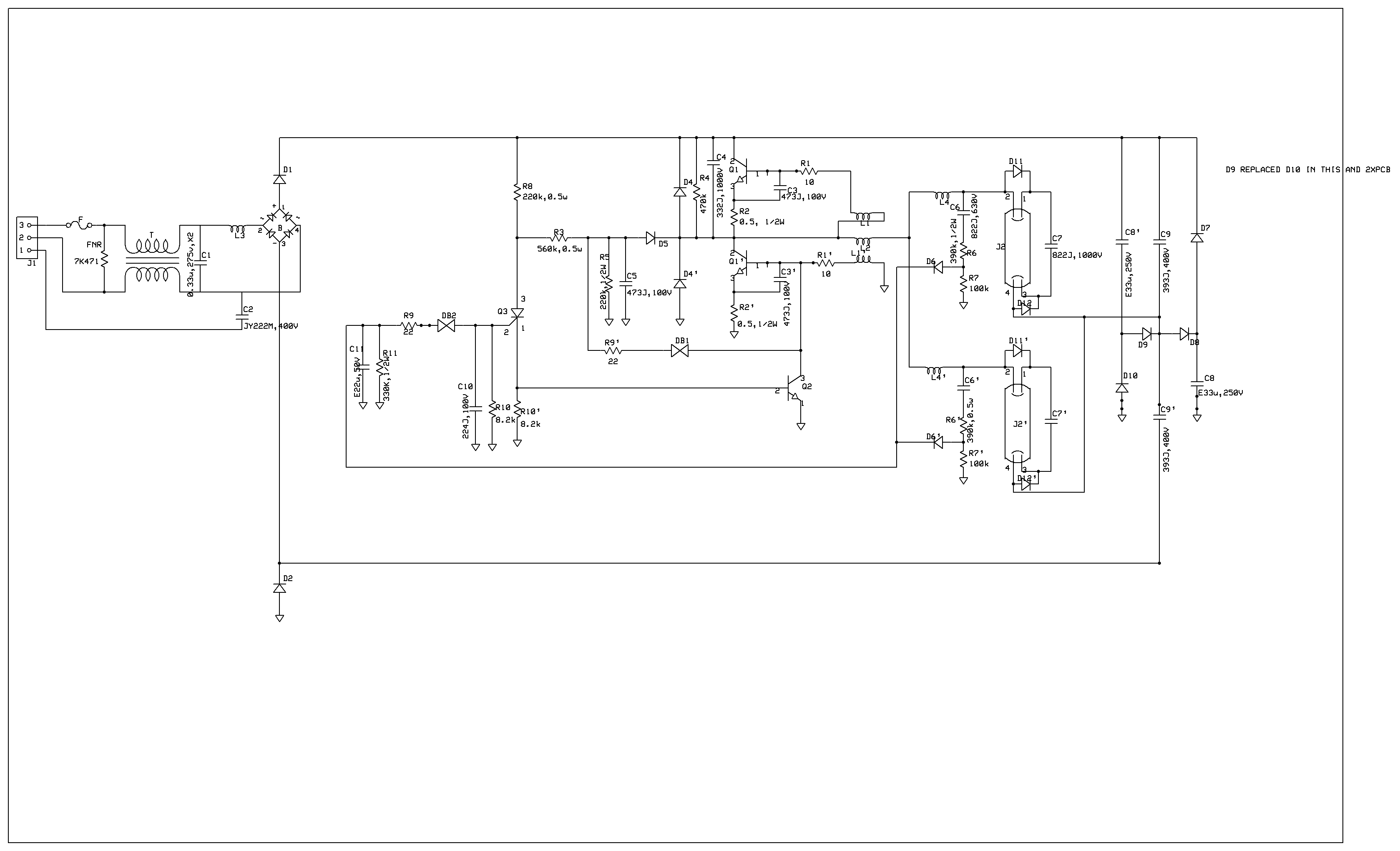

I am making the electronic ballast as attached files. There is something the matter with it. It catches on fire after 2 or 3 days being on without stop.
The main components that burn are R1,R1',transistors, and C8', L1 and L1'.
Please help me find the problem if you know.

the toroid transformer needs to have proper phasing for its coils.
also, the transistor bases should have some terminating resistors. please see the Motorola applications note AN1543M (Attached) on electronic ballasts.
By the way, what is this C2 connected to , supposedly to Ground pin? Please check.
I changed the toroid transformer. It did not catch on fire. But after 3 hours being on, the lamp burst. Why is that?
But what do you mean of terminatin resistors?
I studied the file AN5143.pdf I am having a problem on page 9. In the formula of the 1st paragraphon in the right column and it calls for IP=0.35 Where does it come from?
What is the power rating and length of your fluorescent light tube? Or is it a compact fluorescent light bulb?
If it bursts then you are feeding too much power to it.

Does it mean that 2 lamps together consume 72 watts? what are the Transistors used?
Yes, they consume 72W together. and the transistors are 13007.

I don't know who designed , but on the face of it, perhaps 2*13007 can't take 72watts and the toroid and the inductors are also to withstand saturation, as per present design.
i saw such designs where only the AC to DC conversion is shared and not the other circuit.
the definitions of Ip etc, as you asked in an earlier post, are well described.
