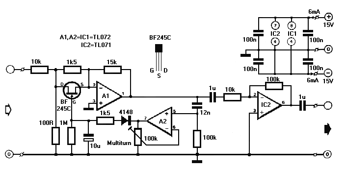

Hi there, I need help with a curcit design.
I can get plans for a "Hard limiter" for headphone amplifiers, but the result is a limited sound (good!) but it is done by clipping the sound.
Can it be done with out clipping, and just maintaining a minimum level, with out clipping the sound, and not going over a determnaed volume?
I guess so, isn’t that what the safe volume limiting system dose on a CD Discman and Minidisk ????
also can this come as a off the shelf chip?
Please help.

might be able to do it with an AGC (automatic gain control) circuit somewhere in this path. You can allow maximum signal to top out without clipping.
What you're looking for is a compressor/limiter - which are basically the same device, but set up and operated in a different way. A compressor will compress EVERYTHING that goes through it, where a limiter passes everything through untouched, UNTIL the signal passes the preset level, when it starts to compress.

You need an automatic level control...
If cassette tape recorders were still made, then a semiconductor company would still be making an audio limiter IC.
AGC wasn't asked for in this thread. Just a simple method to limit the power to headphones. High-power amps limit power to headphones with simple series resistors, so why can't they be used for this requirement?
Two more resistors might be needed to make voltage dividers if the headphones are high impedance, but won't affect the reduction for low impedance ones.
With a second thought about limiting power with simple resistors, just think of the lack of headroom causing the user to "crank up the volume" so the source clips all the time! Horrors, it will be as bad or worse than having hard limiters. :lol:
