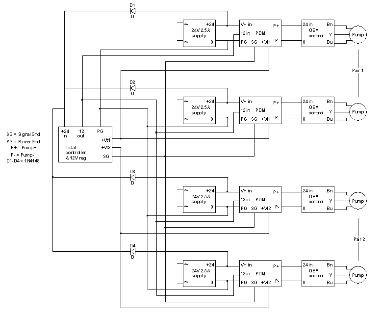

Do you think it would be a good idea to pigtail the 24V and power ground lines from every power supply that came with the new pumps before sending 24V and PG to the controller? I'm afraid if I use 24V from only one new power supply, everything will shut down if that particular power supply fails.
https://www.electro-tech-online.com/attachments/tidalsystem-gif.71768/
Good idea re backup. However, you can't directly connect all 24V lines together.....the supplies may fight each other. Instead, you could connect them via respective diodes (1N4148 will do) to the 24V terminal of the controller so that you have backup. In other words you would have the cathodes of 4 diodes connected to the controller 24V input; the anodes of the diodes would be supplied respectively by the four power supplies. The power ground lines are already connected together in the schematic.

The 24V input to the timer/controller is only used to derive the 12V supply for the logic ICs, so only a few mA needed.

Two pairs of the new pumps in wave mode and two pairs of the new pumps in tidal mode. I connected eight diodes to tie all eight 24V lines together-works beautifully. Thank you Alec for helping me get backup for the pumps.

When everything is hooked up to a pair of PDMs as shown in the link except all 24V lines are fed into the anodes of 8 1N4148 diodes, (8 pumps, 8 24V lines, 8 diodes)a single power supply runs both pumps. The cathodes of the 8 diodes are connected together to feed our controller.
When everything is hooked up to a pair of PDMs as shown in the link, https://www.electro-tech-online.com/attachments/tidalsystem-gif.71768/ the only pump that runs is the one connected to the PDM that has 24V going to our controller. That’s with two power supplies hooked up.
:confused: Is that 8 pumps or 2 you've got hooked up?
:confused: Each new pump should have its own OEM supply.
:confused:The OEM supplies, not the PDM, should provide the 24V to our controller via the diodes. Here's how I see it:-

I have been working with only a pair of PDMs and two new pumps. When hooked up as shown in your link, the pumps work as expected. Each pump is driven by its own PS. If the PS that has 24V running to our controller is unplugged, both pumps die, so I tried the backup.
I connected the cathodes of 8 diodes and ran that to our controller’s 24V. I connected the 24V from both PS to individual anodes. A single PS plugged into either PDM makes both pumps run. Is that OK?
Something wrong there. If one PS (I assume you mean the new PS which came with the new pump) is trying to drive 2 pumps it is overloaded. Presumably it has internal protection to prevent damage. I don't see how, if the setup is as in post #1915, 24V gets from a single PS to more than one PDM (and hence via a respective OEM controller to a respective pump)?

I'm puzzled by your reference to the PS. If you mean one of the old PS's then that should be removed; the setup shown uses only the new PS's, with their outputs 'OR'ed by the 1N4148 diodes to provide a backed-up 24V to the voltage regulator in our controller.
Sorry for the PS confusion. I am working with two new PS, two PDMs, our controller, two new controllers and two new pumps.
The PDMs have separate 24V and power ground lines. They share signal ground, 12V, and Vt lines.
With everything hooked up according to post 1915, each pump seems to run on its own PS. If the PS that does not have 24V connected to our controller is unplugged, only that pump stops. If the PS that has 24V connected to our controller is unplugged, both pumps stop.
The only change made was to take 24V from each PS and connect them to individual anodes of 1N4148, then running a wire from the connected cathodes to our controller. Then, as soon as a PS is connected to either PDM, both pumps run.
This is where I'm getting confused. Don't all the PS's have 24V connected (via diodes) to our controller?
