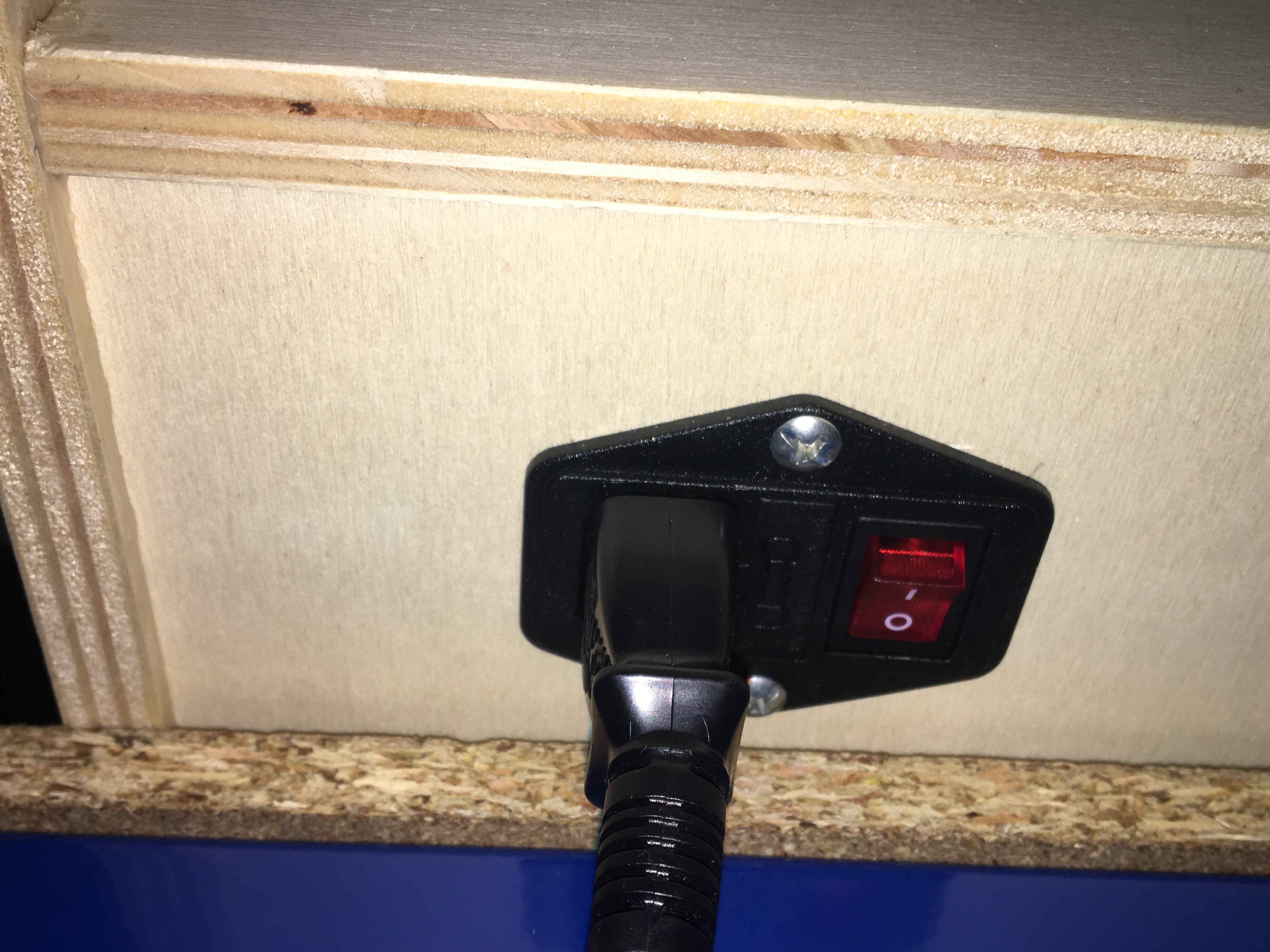

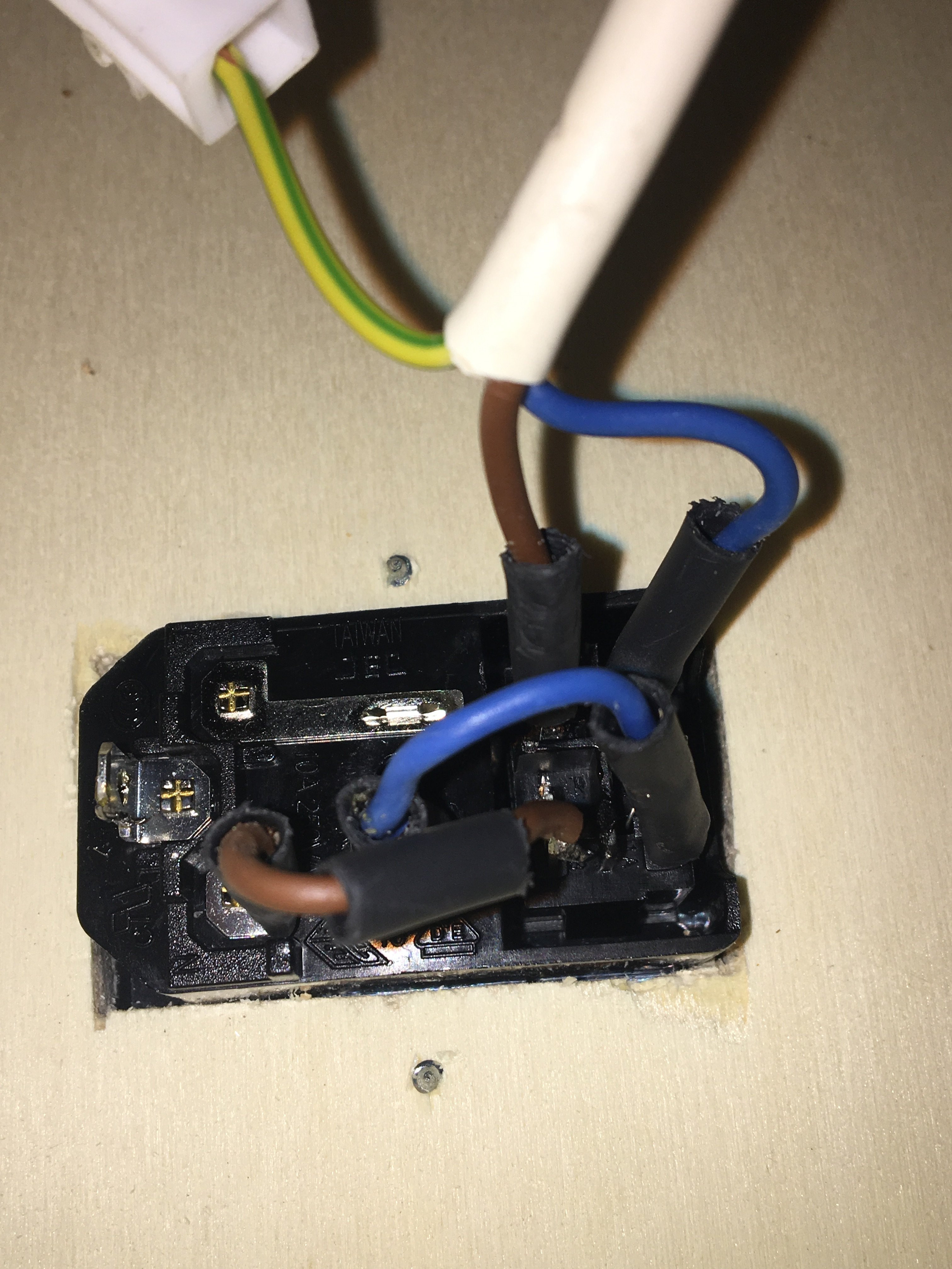

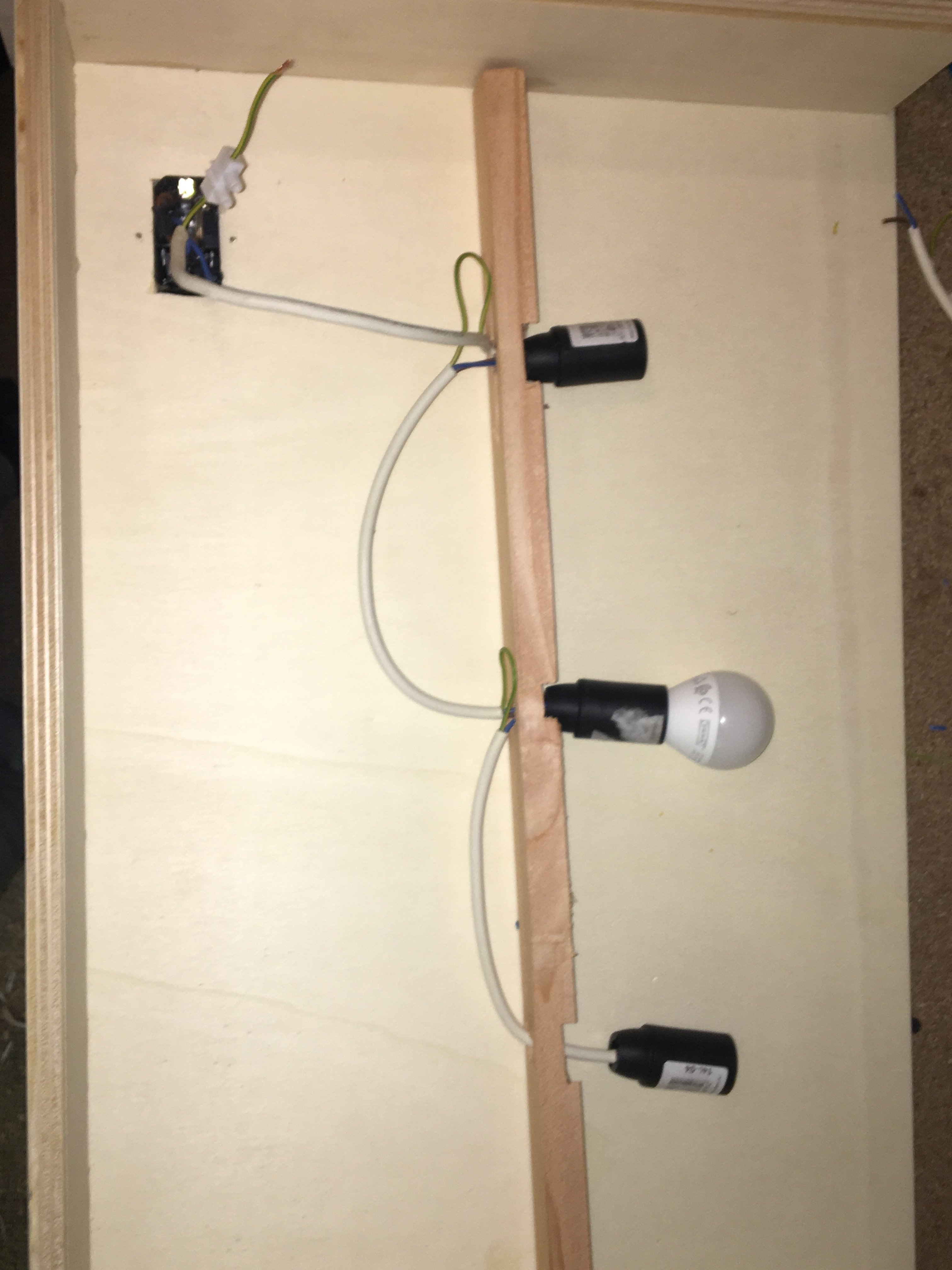

Hi, found this thread and hope u can help me: i wanna hook up 3 standard 250v 5w led lamps with an iec230 power switch. The setup is seen in the pictures - and its not working :( . i dont know what im doing wrong.
The bulb sockets do not come with a ground-wire option so left in unused.
I want the lamp of the switch to turn on when the lights are on.
Thx
Edit: I found the problem, everything was in order except the fuse was missing. I didn’t know this thing had a fuse until I checked.
