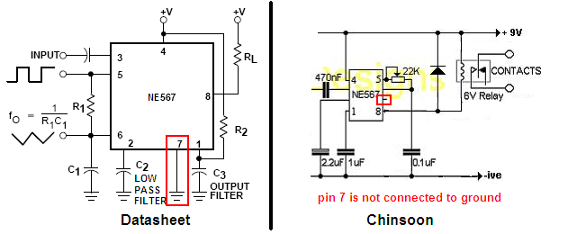

Yes, one side of the relay is connected to the + supply and the other side connected to pin 8. It is because pin 8 is the collector of a transistor. See the attachment, we turn on the relay in this way, right? If the relay isn't being switched, I think pin 3 is not getting any signal that matches the fo, not sure.

The LM567 is exactly the same as the NE567.
Their datasheet shows pin 7 as the ground pin that Chinsoon didn't connect.
If pin 1 has a 130k resistor to the positive supply then the input sensitivity is 20mV to 25mV RMS. Without this resistor then 100mV RMS is a normal input but is probably not availabe from a super-regen radio without an amplifier.
The datasheets show a relay coil and protection diode connected from pin 8 to the positive supply and up to 100mA is available.

If the resistor is connected from pin1 to the supply, won't the sensiticity be reduced? You mean, without the resistor, the sinsitivity is 100mV rms, which is the amplitude of the input signal at pin3 right?
Yes, you are correct, I was wrong.
Actually, the sensitivity is reduced with the resistor from pin 1 to the positive supply and the sensitivity is 20mV to 25mV RMS. So without the resistor then the sensitivity is higher. then a lower input signal will trigger it.
The datasheet shows a 100mV input signal.
Use a BJT as amplifier from a super regen before feeding in the PLL would work?
Yes, it is easy to overdrive a transistor then it will have a distorted output.
I don't know if the sensitivity of the 567 IC is reduced if the input is distorted.
From the datasheet (your attachment), it shows that the sensitivity is increased if the resistor is added from pin 1 to ground. I've tested this with the fo of 200 kHz, it works the same with and without the resistor. Maybe because of the minimum output of the function generator is 100 mVrms.

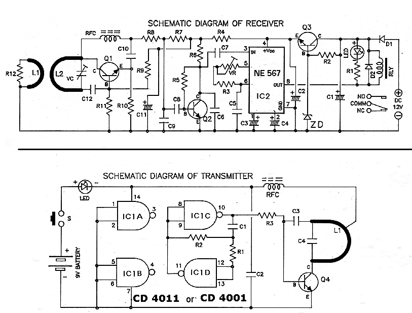

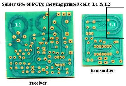

this is the receiver... can someone explain how the L1 and L2 work? on the PCB board, its copper strips on it.. (attached also)...
so can i replace it with jumper wires other than using the strips? what i found out is that this will affect its frequency...
and how does that transistor Q1 and Q3 works? Q2 is an amplifier right? but just cant "see" how Q1 and Q3 is biased....
thanks
They are the tuning inductors (lecher lines), they need to accurately made, and stable - randomly replacing them will send the frequency anywhere!.
thanks
Q3 is a voltage regulator, a simple emitter follower. Q1 is a crude super-regenerative receiver - and is conventionally biased, just drawn on it's side.

They are the tuning inductors (lecher lines), they need to accurately made, and stable - randomly replacing them will send the frequency anywhere!..
so does that mean that i cant just simply replace the strip with a jumper wire. what if i want to adjust its frequency? if there is any difference from the frequency that it is suppose to be, cant the capacitor compensate?
The voltage regulator part ok, but about the Q1, don really get it. what do you mean that it is conventionally biased?
The capacitor can compensate to a certain extent, but slight changes in the lecher line will produce a much larger change.
Collector to +ve via a load, emitter to ground via a resistor, base biased with a potential divider - exactly as biasing should be.

lets say if i want to do some modification and the PCB board needs to be changed, can i just follow the curve part of the copper strips? and the rest changed according to what i need to solder on. The curve copper line is the one that affect the frequency right?
L2 and the trimmer cap form the LC tank circuit.
No, the entire track affects the frequency, in fact lecher lines are usually just straight.
is there anyway to calculate the theoretical value of the frequency of that tank circuit?
by the way, why must there be 2 curve copper lines there? what is L1 doing there?
Presumably, but I've no idea what it would be.
It's the primary of a transformer, matching the impedance of the aerial to the impedance of the tuned circuit.
