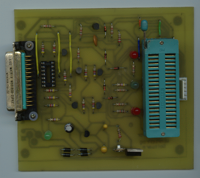

Eh mate on Nigel's site is a link to the Ozipic's programmer schematics, below is a pic of it. It's the first time I've ever made my own circuit board and it's so hot of the press I haven't put in the 74HC14 chip or the power supply yet. I've just got to check there is no shorts on the solder side then tonite I'll try it out. Rather than go straight ahead and make the ICD clone I made this programmer as it's got ICSP on board and also I had all the bits. What do you guy's think of my first foray into makin me own circuit boards.
Cheers Bryan :D
Edit:- Well after spending all day trying to get it to work after continually getting the dreaded error at 0x00000. I ended up replacing half the transistors and played with the lm317 only to finally conceed defeat and go ahead with my original plan, which is build an ICD clone on veroboard. Well I did learn a good lesson don't bother making me own pcb's when veroboard is just as good for most projects. My attempt at using press'n'peel worked after the 4th attempt and sore fingers from scrubbing the board clean. Well after 3 days of work I put it down to a good lesson don't change tack just cause something looks good.

bryan, don't give up!! PCBs are the way to go!! Just beause this one didn't work doesn't mean the next one won't. PM evandude about his PnP blue sheets, he is always bragging about how well they work, probably a lot better than the ones that you have. I have converted to the phototransfer method and have been getting superb results.

Yes Bryan, don't give up! I might not have the wisdom of Nigel and audioguru (think about it, their combined age is more than 110 years, and I think they might be telling us their age in hexadecimal... :lol:), but one thing that I've learned early is that perseverance always wins, no matter what you're trying to do.
What you have in your hands is not a faulty PCB but an invaluable learning experience. Chances are you will learn a lot by fixing it. Stick to it! Then, when it finally works, build an ICD2 on Veroboard. And finish that too ;)

yea my major problem I think is the mlcr isn't rising fast enough to put the pic into programming mode. I placed the probes off my fluke 865 on the mlcr pin and found as soon as I hit program on the laptop it takes up to 2 seconds for the pin to rise to 13 volts. Also I'm using a 74hc14 chip as recommended on the schematic so that could be a concern too. The ozipic circuit uses a LM317 for the Vpp and I reckon this is where my problem is with varing voltages. Unfortunatley I'm about 60 k's from the nearest electronic store so I can't just zip down the road to get more bits :( . O'well I'm off to try again as I'm without a programmer now I've shipped mine of to the US.
