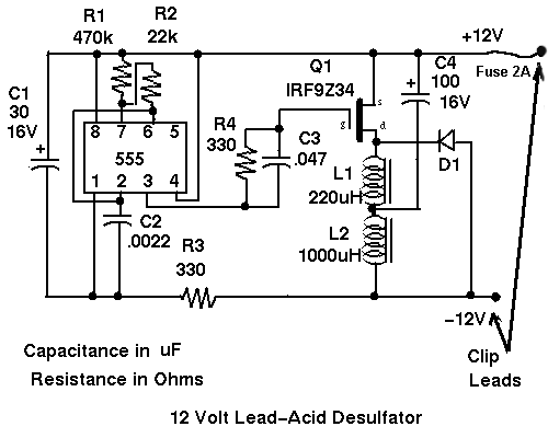

hi guys i am now building a circuit to desulfate battery at higher frequencies upto 2 MHz using 4046. now the old version using 555 timer used switch irf9z34 which has g-source 20 v max. but 555 operated at 12 volts and 4046 at 5 volts (for me) and its output voltage should not be more than 5 volts. i have a question whether i could use the same irf9z34 for this circuit also? please help this is the only component left now. or what could be the other switch used? the the circuit of desulfator with irf9z34 is given here and my maximum output is 4.8 volts. can i use this irf9z34 or please suggest me some other switch.
Thank you.
Happy New Year to All!!!! :)

roltex, the circuit you posted still use a 555, you can't come even close to 2mhz with a 555, they have a maximum frequency of only about 100khz.

hi guys can you all please guide me the question of irf9z34 in my new circuit? i have constructed something much different and exciting than the schematic. the schematic posted here is just to tell about the irf switch. but in my circuit the situation is as given:
output voltage is 4.8-4.9v; 20uA can i use irf9z34 for it. will it burn my ic? please guys i dont think arguements would help me. i will post my schematics if my experiment is a success. but for now can we get back to work? and do tell me how you celeberated new year!! i will be starting a new, more practical project after this one but first help me completing this one. may be a dumb one, but this is my first project, i dont mind this one failing.i have also bought all the components and fully invested, and if i dont construct this one, then my mate would be furious.To tell something, this not only pulse the battery but there are many advantages over the old one.

That mosfet could work fine, but you'll need to add a driver to it. It turns on at -10V, so your 5V supply is not enough. Plus, 20mA of current is MUCH too small to make it switch quick enough; you'll need something more like 1-2A. Add a high-side mosfet driver using the 12V supply and it should work fine.
Either way, you're going to need some sort of driver due to the 20mA output limit.
