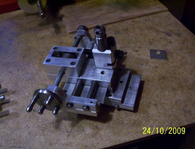

Here is my taper attachment I made, it replaces the whole crosslide.

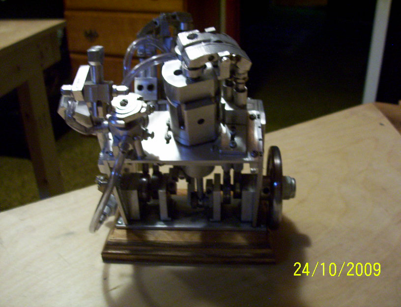

And my latest steam engine (compressed air engine)

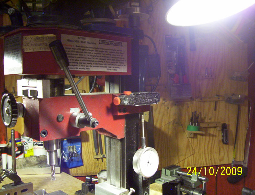

It looks like you have the same micromill I use. I suspect you will soon be frustrated by the inaccuracy of the downfeed. Here is how I attached the dial indicator mentioned earlier. You could drill and tap the headstock, but using the tension adjust screw works, and the indicator is easily moved out of position, if you need more than the 1" travel it allows. I made brass stand-off washers to fit into the csk hole on the headstock. That way, the mounting lug is riding between washers and is not pressed directly against the casting.

Do you have any excess vibration with that setup?

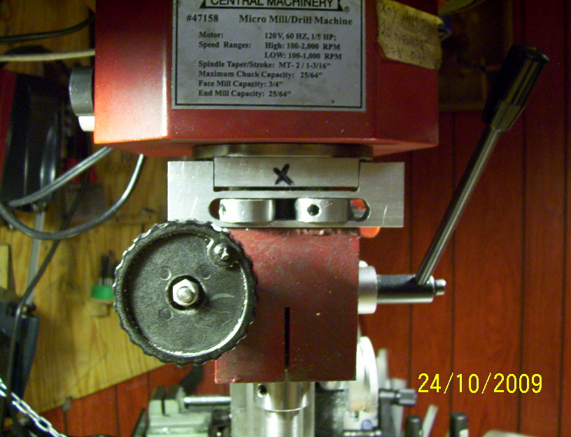

Because, I had troubles with keeping vibration at a minimum, when endmilling due to the headsock gearhousing being used with the microdownfeed engaged.
So I engage the microfeed and twist it to the left until its tight, then tighten the dial on the lever arm keeping everything tight, then to keep the gearhousing from working in a loose manner, I made this adjustable bracket, to keep the housing tight with the rest of the headstock.
Then all my depths are microfed adjusted through the Z axis lead screw to 1/2 thou. accuracy if needed, using the dial indicator against a magnet at the top. And the dial indicator is on a magnet also, for adjustablility.
Your method is certainly more rigid. I hooked mine up after I had just made a counterbore about 0.015 too deep while depending on the fine feed calibrations. So, I wanted something simple and fast.
I keep the quill fairly tight and the fine feed engaged while milling. I have not had problems with it vibrating up. Of course, I always set it from the same direction (push).
