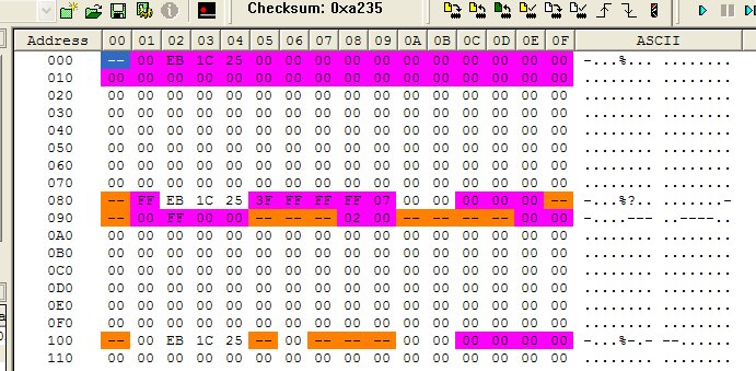

I know it was falling thru and restarting. That shouldn't prevent the array from being initialized, should it? I only ran it in the sim, so it basically got single stepped only.
And in my other programs, which were properly terminated, the same problem happened.

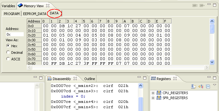

I ran the program in MPLAB sim and I could see the correct sequence (4,5,8,9,8,1) at location 0x22. Then the program exits the while loop as expected. As you know, the following endless loop is important in order to avoid weird results.
I put the endless loop in, recompiled and stepped thru it. The array is still all zeros, or whatever leftover junk was in RAM there.
It looks ok here :eek:

futz said:
PICC Lite v9.60 + MPLAB 8.02.00.00
If you have installed HI-TIDE, you can use its debugger and see what happens. Again, I got correct results here.
