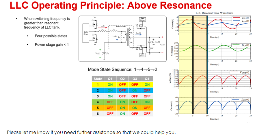

Thanks for that article...i am not sure about that doc...because on 6th page (marked pg 5), they say....
(regarding operation above the resonant frequency)....
QUOTE.....
**The rectifier diodes are not softly commutated and reverse recovery losses exist**
...this is completely wrong....and is a basic situation of the LLC converter.
And it is in fact, common to operate an LLC above f(res), because you are further from the capacitive region....and your RMS and peak output current is lower.....

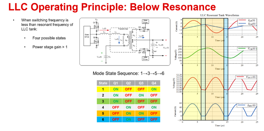

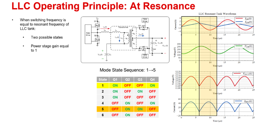

This is what I got back from TI -
Hi Dana,
Here is the feedback of our product specialist,
When you operate above resonant frequency, secondary side rectifiers wont have zero current switching, so there will be reverse recovery.
Below and at the resonant frequency, secondary side rectifiers do have ZCS switching.
However, As move on left side of the gain plot curve (away from resonant frequency and towards left side of gain plot curve) of LLC, conduction losses will increase.
So ideal point would be to operate the converter at resonant frequency for rated power. So, the design should be made that way to achieve high efficiency.
Please refer the following screenshots for the current waveforms on both primary and secondary:
Regards, Dana.

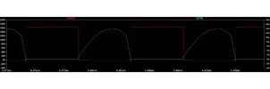

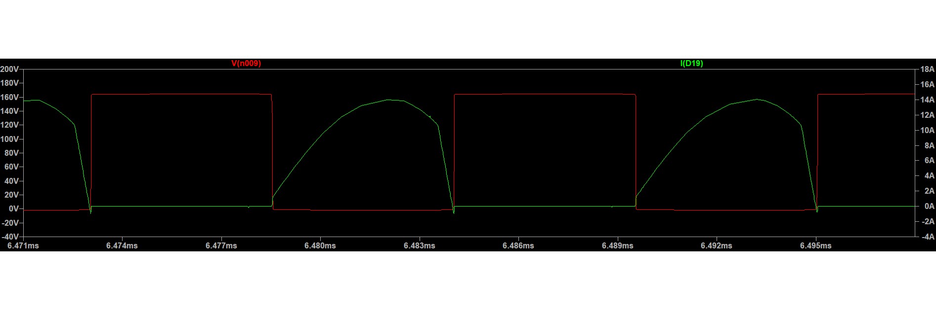

Thanks Danadak, but they are wrong....if you run the attached LTspice sim you can see.
Also attached is sec diode voltage when above resonance......no reverse recovery......when diode current goes off, the voltage across the diode was already zero...the reverse voltage did not build up across the sec diode until the diode current had gone to zero.......green is sec diode currnt...red is sec diode voltage..
Reverse recovery, AYK, is when a diode that is conducting current, suddenly has a reverse voltage put across it....and a large current spike flows through the diode in reverse direction...........as can be seen, this does not happen with LLC above resonance.

Next reply -
Hi Dana,
According to our product specialist,
During above resonance, the current slew rate is very high (compared to other modes) just before current going to zero.
I believe this is what it causes the reverse recovery (reverse recovery is a function of current slew rate).
Regards,
Danilo Austria Jr.
Texas Instruments Customer Support
Sorry but they are wrong again.........i can see what they in fact meant to say...............they in fact are talking about a situation which happens when the dual sec windings of a CT output LLC are not well coupled....but they make no reference to that whatsoever....what they have actually written is complete and utter nonsense.
It looks to me that some specialist, who maybe no longer works there, explained it to the writer, and the writer got it all mixed up.
