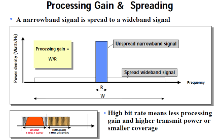

I read in different articles that in WCDMA, when a transceiver is to transmit a high-spreading factor code (a code with a large length), it transmits it in low data rate, as oppose to a low-spreading factor code (a code with a smaller length), which is transmitted in larger data rate.
What is the reason behind it?
Thank you.
*In the below article, they call "spreading factor" as "processing gain".

The higher the spreading factor the higher the coding gain. It gives better sensitivity at expense of lower data rates. Low spreading factor requires more power to accomplish a satisfactory bit error rate.
This is all under the usual restriction of a given bandwidth.
CDMA builds the recovered data bit by correlating chips of higher rate data. The high rate data in this case is the the unique spreading psuedo random sequence that is exclusived OR'd with the original true data bit.
In CDMA, much of the 'noise' in the signal to noise ratio is uncorrelated noise from other users on the RF channel. Traditional way of specifying sensitivity as uV's for a given S/N ratio doesn't have much meaning in CDMA shared RF channel. Other user's raise the noise floor of the communications channel.
Low spreading factor (high real data rate) quickly falls apart as more user access the channel. With only 4 to 16 spreading chips to correlate it becomes hard to distinguish a given user's original data from others.

Not sure I understand the question you are asking. It all depends on energy per bit. (not chip) Energy being power over time period. CDMA allows a given amount of bit energy to be spread over any amount of spectrum. Even though the energy per Hz goes down for wider spectrum, the energy per re-correlated bit remains nearly the same. Raise the data rate and you must raise the power to maintain same energy per bit.

High data rate means the spectrum is already saturated, if you try to use a high spread factor the signal will be stretched out of it's possible spectrum allowance.
Hi Sceadwian.
Please tell me if that was what you meant.
SF = Chips rate / Data rate
Chips rate is constantly equal 3.84MHz, right?
So:
SF = 3.84MHz / Data rate
Therefore, high data rate means low SF, is that how you reached this conclusion?
Yes that's the gist of it.
