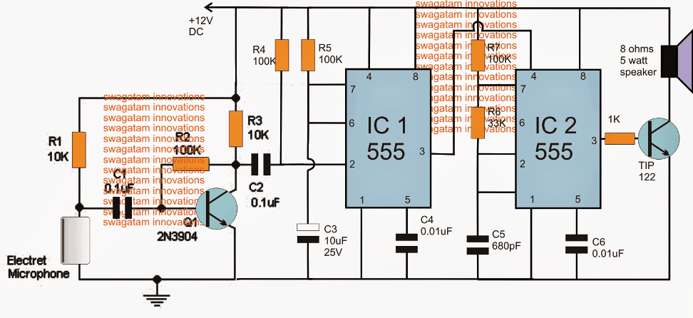

Back to my original plan..... How about just the dog bark detector circuit ?
There are a few designs here:
Does anyone have a design of their own?
What brains are inside a "dog bark detector" to prevent it from detecting any noise like people laughing, a motor cycle or an ambulance siren??
You found a circuit that plays ultrasonic frequencies into "a speaker". Most speakers do not work at ultrasonic frequencies and the DC in it from the circuit might mute the speaker anyway.
