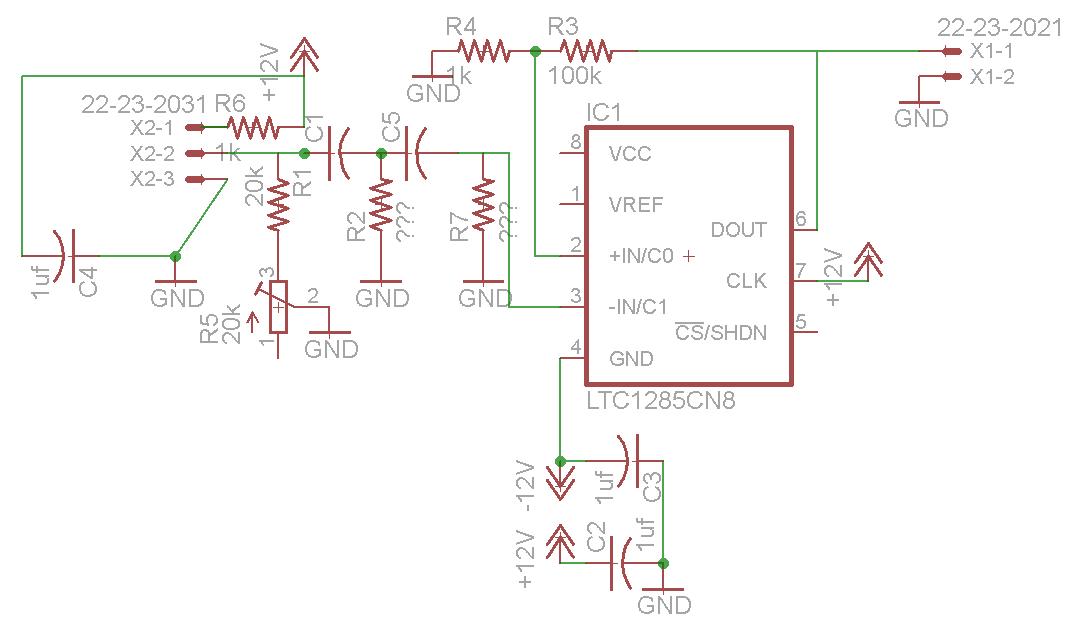

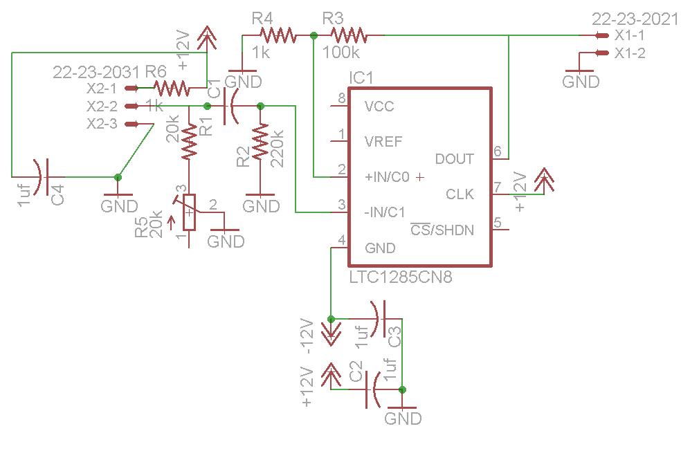

//What I'm looking at in the interests of time if no one outright says it's a bad filter - is a two stage high pass filter where I'm trying to figure out what my resistor values (the ???) need to be in the "2 //stage filter sc" where I've got 1 220k ohm in the "current amp schem" and I think my input bias current (if that's what you're supposed to use to determine the resistor value in the op amp) is 50 uA, //so V=IR, V=11. Which actually doesn't sound right, but it seems to work... anyway, how do I make sure the same voltage goes through with two resistors and two capacitors?

I really would like to assist you but up to this point you have failed to help us, help you. At this point we can only speculate on what you have going on, as you have not provided any sketches, diagrams of your system configuration. At this point I think you may be chasing your tail and building filters may not be the solution as the real problem has not been identified. As of yet, you have not mentioned how your cable shield is grounded, is it like in fig 18 of app note I provided? Too many unknowns so I am at a loss. Is your high gain amp at the far end of the sensor or at the sensor side of things? Maybe you might consider using a differential driver and receiver for the sensor data. The differential method is good for noise immunity. Anyways good luck.
Mike I apologize for failing to answer any question as I have tried to address them all, but I believe I have addressed or attempted to address the above questions and was not clear enough or I didn't understand the question well enough to answer. This is a long thread and there are lots of questions and lots of answers.

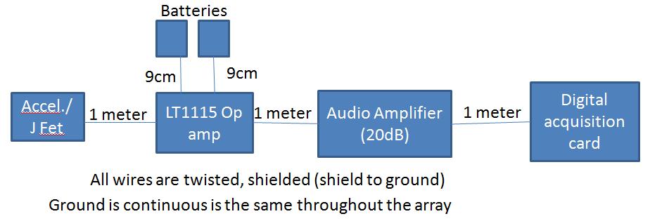

A sketch is attached.
All wires are twisted, shielded (shield to ground).
Aside from that, I have stated in my last post the source of the noise and requested advice regarding the problem. I'm not sure you read the last post, as I identified, at the least, the source of the problem, but not a complete physical reason why it's happening.
