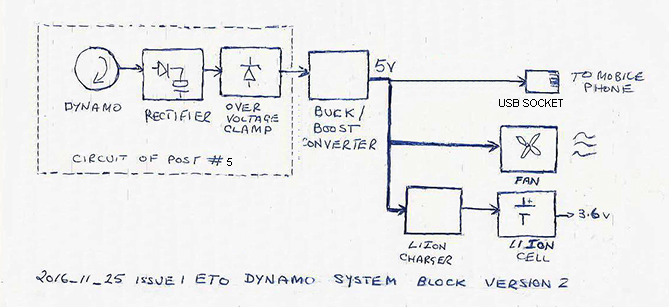

When i multiply the capacity by 1.4 (why 1,4? loss of current?) and divide it by the output current i know the time it takes to charge the battery pack.
Hi splinter,
You ask why 1.4: it is convention to specify an alternating voltage or current, in terms equal power (heating effect) to a DC voltage or current.
The mains voltage in Belgium is 240V RMS at 50Hz which will have the same heating effect as 240V DC. RMS stands for root mean square.
The relationship between the peak value of an AC voltage or current is RMS value * ( the square root of 2).
Thus, RMS * 1.414 = peak value of RMS AC.
In the case of your mains supply, the peak value of the sine wave = 240V * 1.414 = 339.36V and the peak-to peak voltage is twice that, to include negative and positive excursions of the sine wave = 678.72V.
The consequence of all this is that if you connected the bridge rectifier of post #5 to your mains supply (you would need diodes with a PIV of 407V or more) you would get 339.36V - (2 *0.4V) = 338.56V across the reservoir capacitor. The (2 * 0.4V) loss is for two Schottky diode forward voltage drops.
End of lecture.:)

Spec:
Love your HAND-DRAWN schematics. They are so clear and legible.
Reminds me of one of Electronic heroes, Forrest Mims III.
Thanks ST,
The circuits are just sketched out on the settee while watching TV/listening to my missus.:D That is why the lines are such a mess. I use sketches for skeleton/outline circuits when I am too lazy/tired to do them in EAGLE.
I try to keep the layout simple because I am not clever enough to follow more complex circuit layouts.:)
