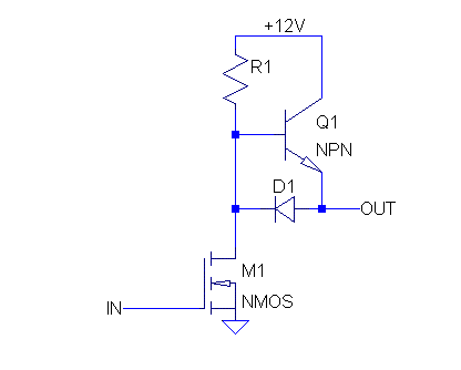

I have used the circuit below for driving capacitive loads. You might want to add a resistor from OUT to GND if you want a solid zero volts for the low state.
Wouldn't touch a bipolar for power apps. Vcesat's like 0.3v, but using an NPN like that is far, far worse- over a volt. And it requires a lot of quiescent current either on or off... and it will reverse bias the base, which will kill it if it's enough voltage.
