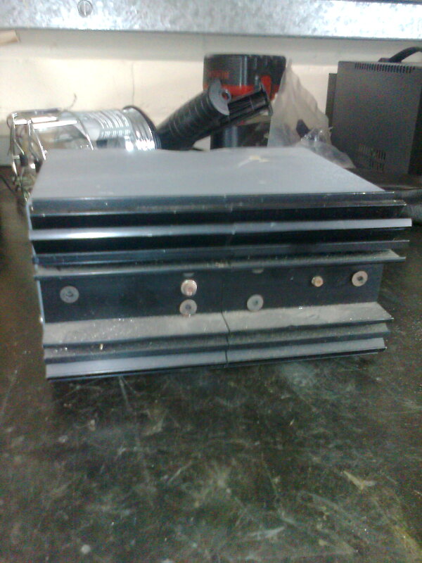

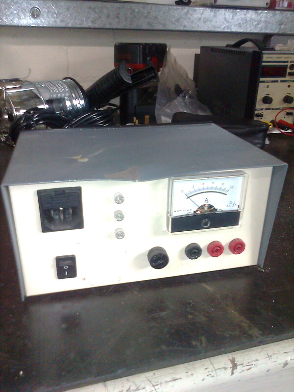

Heres a 8 amp 3 stage charger I made that keeps my boat battery healthy, its a linear regulator.
You are correct .... to determine the power dissipated in the transistor (BJT or MOSFET)? is it (input V - output V ) * current passing through it. Look at the data sheet for the particular device you choose and make sure you are operating it in the "safe area of operation". Also be aware of theheat being generated and use the correct heat sink required to disipate the heat from the transistor.
