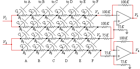

Hello,
This circuit is a Hilbert transformer from ARRL Handbook, that I want to use it with MC1496 balanced modulator to generate SSB from DSB via phasing method.
The Hilbert filter generates a 0 , 90 , 180 and 270 degree phase shifting for the op amps and finally we will have a 0 and 90 degree phase shift at the output of op amps(which I want to use a TL072 op amp at 12V single supply).
Now I wanted to know if the wiring is correct for the input of op amps or not?
I think there is a problem because it seems that the + and – of an op amp is connected too 0 and 180 degree and the input of the other op amp is connected to 90 and 270 degree pin? So how we can have a 90 degree phase shift at V3 and V4(outputs of the op amps)?
Another question is that I have heard that a Hilbert transformer is working fine at the range of 300 to 3000 or 3500Hz, if so, can an expert let me know how it works on voice Communications!?
Thanks for any help.
C1: 0.044 uF, C2:0.033 uF, C3: 0.02 uF, C4: 0.01 uF, C5: 5600 pF, and C6: 4700 pF AND all resistors are 12K ohm 10%

The top opamp in the circuit is taking the 0deg and 180deg signals and amplifying the difference of those two signals.
Similarly with the lower opamp, it is amplifying the difference between the 90 deg and 270 deg signals.
The result is two signals one at 0deg and the other at 90deg.
The frequencies used for voice communication are 300 to 3000 hz, this is fairly standard for any radio or telephone voice comms.

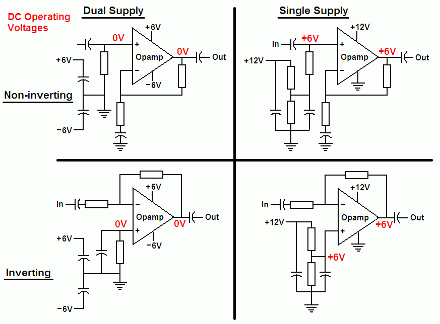

The 75k resistors to ground make the non-inverting input voltages very close to ground. Since you want a single supply of +12V then the input voltages are much too close to the negative supply voltage ( ground in your circuit) to work. The fix is to have a positive and a negative supply voltages, or use a 3rd opamp to make a V/2 reference voltage for the 75k resistors, and capacitor-couple the inputs.

Thanks Jim,
Difference between 0 and 180 degree is = 180 degree,
Difference between 270 and 90 degree is = 180 degree.
so How we can have a 0 and 90 degree?!
thanks audioguru,
No I can not to use a negative supply because it makes me to change whole my circuit.
Ohh, now that I think I see that the reason that a lot of my circuits based upon op amps did not work is that I did not care about V/2 and negative supply(I used them with single supply).
Please can you let me know more about that?
can you let me know the best choice for make V/2?Is that way perfect and works just fine like a negative supply at all Frequencies?

I drew opamp circuits that work nearly the same with a dual supply as with a single supply. But not at very low frequencies nor at DC.

The 0 and 180 are added together.
The 90 and 270 are added together.
You then have two signals at 0 and 90, (or is it 0 and 270, or 180 and 270, all the same thing!).

I think the Hilbert transformer has a top end of only 3kHz to 3.5kHz because it needs many more RC stages having capacitors with reduced values for it to phase-shift higher frequencies. Then the values of the 75k resistors will need to be increased for the gain to be the same as now.
Yes audioguru, I will need A LOt of RC component to do the job for 20kHz too
