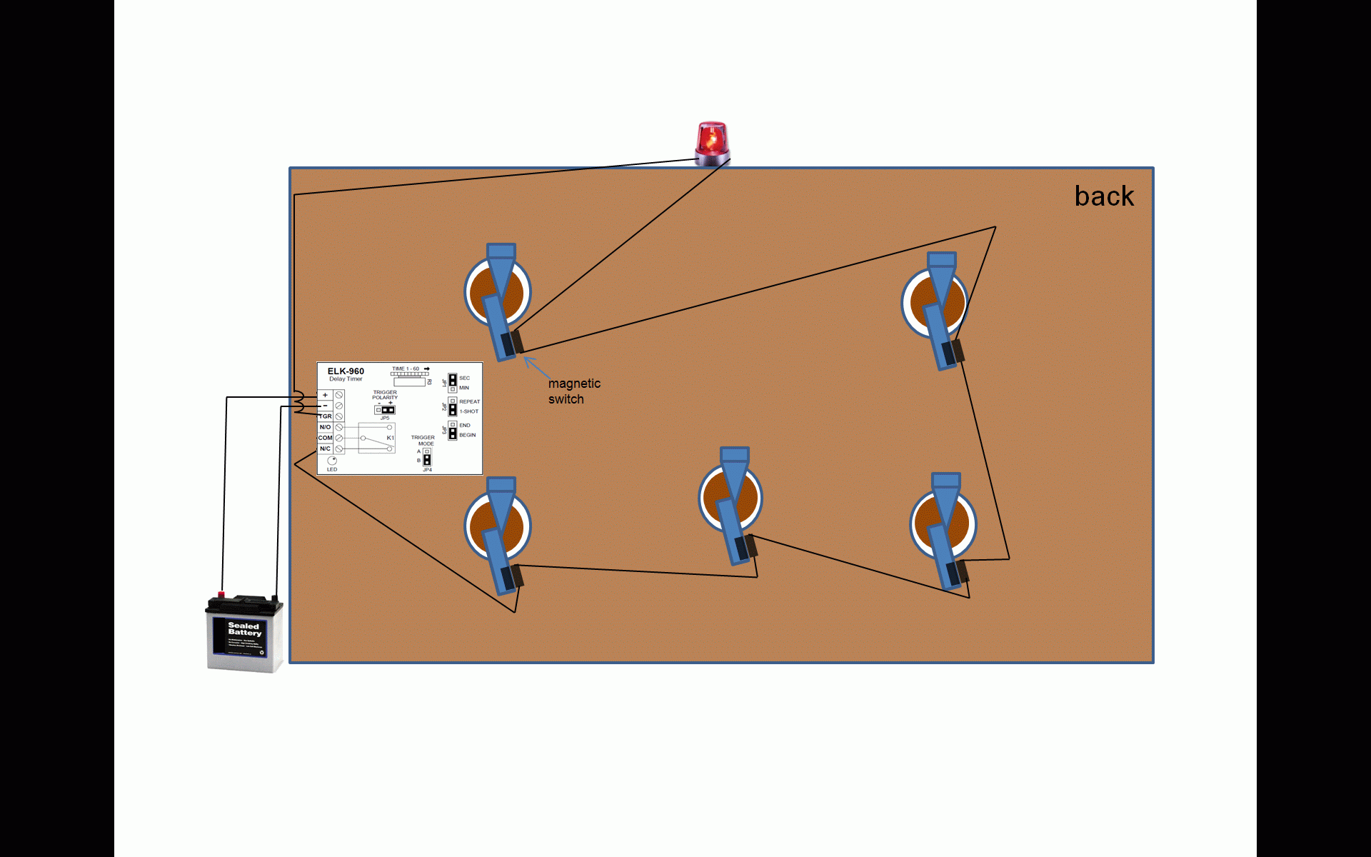

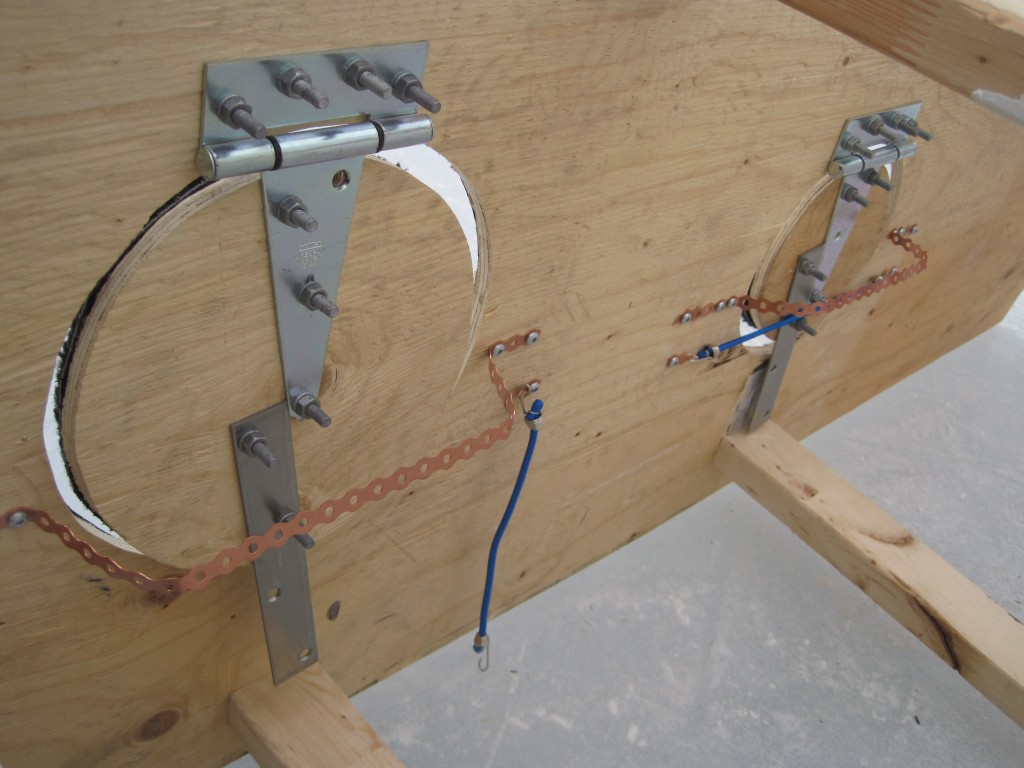

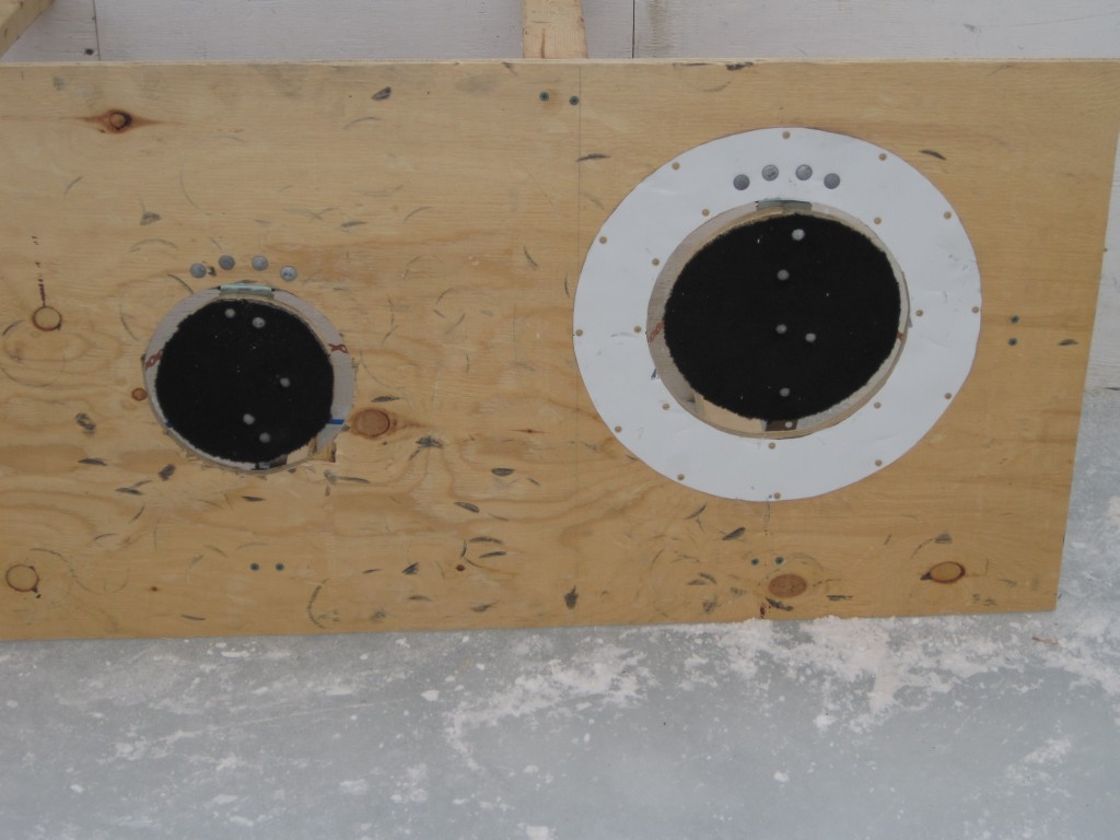

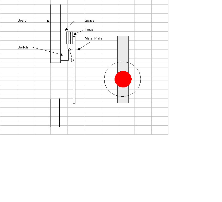

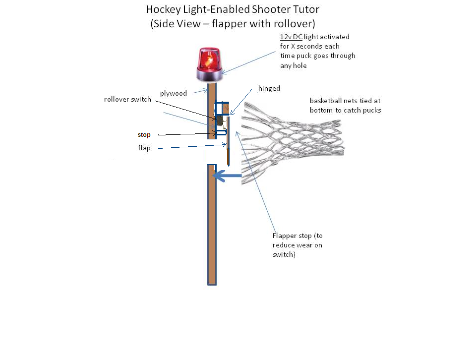

I have a question about a trigger system. I want to make a hockey shooter tutor as depicted in the images below. The puck passes through a hole in some plywood, and sets of a light to reward the shooter. Here are my ideal operation parameters:
1) light is AC - household wall plug, because this will be outside on a rink
2) putting puck through any hole should set off the light.
3) the light and trigger system should reset by itself in a short period of time - 5 seconds or less - to facilitate rapid fire sessions with several pucks. A mechanical system is fine, but I don't weld.
4) I am not an electrician or electrical hobbyist so speak slowly...
Thanks for sharing your thoughts.
Yes, the light will be behind a mesh barrier so shooters don't pick it as target #6!
