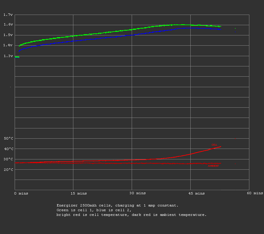

Hi Scott,
When you get the new cells you can try them but this time monitor the temperature of one of the cells and when it goes up by say 20 degrees C stop the charging even if you have to disconnect them. The cells should not get warm or hot until after they are fully charged, so if they start getting hot you know they are done. At least this way you can protect the new cells while you are testing.
Here is a graph of measured data, taken on two cells while measuring the temperature of one cell and ambient.
Note how the temperature rises more sharply once the voltage plateau is reached (end of charge).
This suggests a 10 deg C rise is enough to tell us that the cell should be disconnected.
