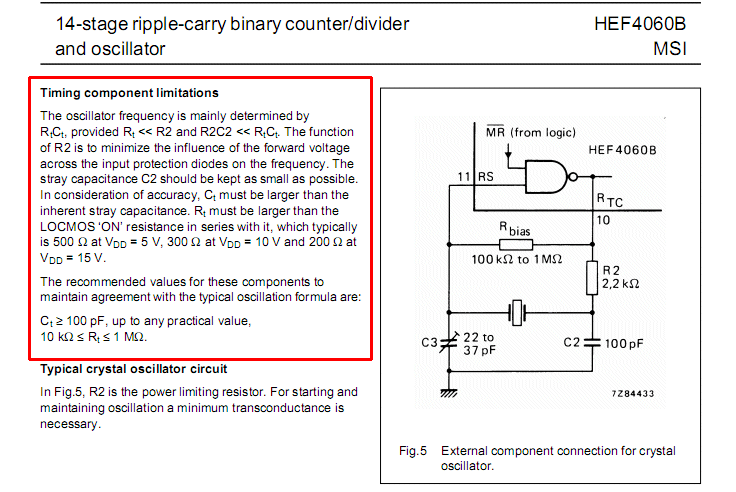

I've spent the evening looking for an app note for the 4060 that included information on which crystal, resistor, and capacitor combinations provide what frequency. I didn't have any luck, it's not included in the standard datasheet. Anyone have any thoughts?
Look at this datasheet.

I saw that one too. No help. All they say about the crystal-based circuit is "In Fig.5, R2 is the power limiting resistor. For starting and maintaining oscillation a minimum transconductance is necessary."
I would say there is enough information on this clip from the 4060 datasheet to get all you need for a crystal oscillator to work.????
Or are you asking about CMOS crystal circuits generally.??

Read it closely, real close. It took me almost 10 minutes to understand what it was talking about and why it didn't make sense in reference to the figure next to it. Notice there is no mention of the crystal in the highlighted passage. That passage applies only to the RC network in figure 5.1, not the XRC network in figure 5.2.
I would suggest these pdf's will give a complete picture of crystal osc's.
