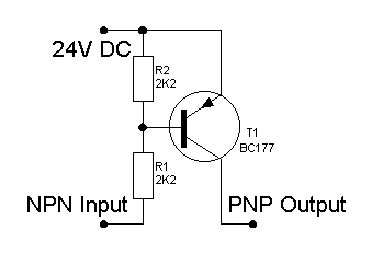

how can i change an npn sensor to pnp
markthe spark
we have a npn sensor with 3 wires (24vdc)
but our machine is from japan and is pnp
can we change this sensor to pnp somehow or by using
relays?

Sensors aren't NPN or PNP, those are transistors - your question doesn't make any sense!.
I'm presuming your sensor doesn't match your machine?, but we need to know more details about both to offer advice. For a start, what kind of sensor is it?, is it an analogue sensor? (with a variable voltage output), or a 'digital' sensor, with a simple ON or OFF output?.
this is a digital photo electric cell(allen bradley), 10 t0 30v dc, 3 wire
npn with the switch wire just on /off, when connected to our machine
the sensor just stays on all the time, as the manufacture's state there
machine is pnp, can we make this into a pnp or get it to switch on and off
or do we need to buy a pnp type, hope this helps

What type number is the sensor, we can then look on the net for details!.

allen bradley p.e.c. type 42BA S2LNAE-A2
Looking at the specs this should work fine, it's a very simple thing to do.
The transistor isn't at all critical, any small signal PNP should be fine, depending on the load it's required to pass.

You will notice that 42BA S2LNAE-A2 is NPN so you don't have to change anything. You can use PNP output to drive small relay (700HK slim line from Allen Bradley for example or their twin G2R-SND from Omron).
Use relay contact to turn on PLC input. Even better - use compact relay in form of terminal block or polarity converter block (they are not as popular and hence cost more than relay).
You can also add just simple resistor to PNP sensor (load for open collector - 2.2k 1/2watt is fine) and invert the bit in PLC.
You might be tempted to simply switch "light on/dark on" option on your sensor instead of editing program. Be sure this is safe for the process/machine.
NPN is very common for sensors and PLC comming from Japan and all their equipment I've worked on so far was always using NPN types.
