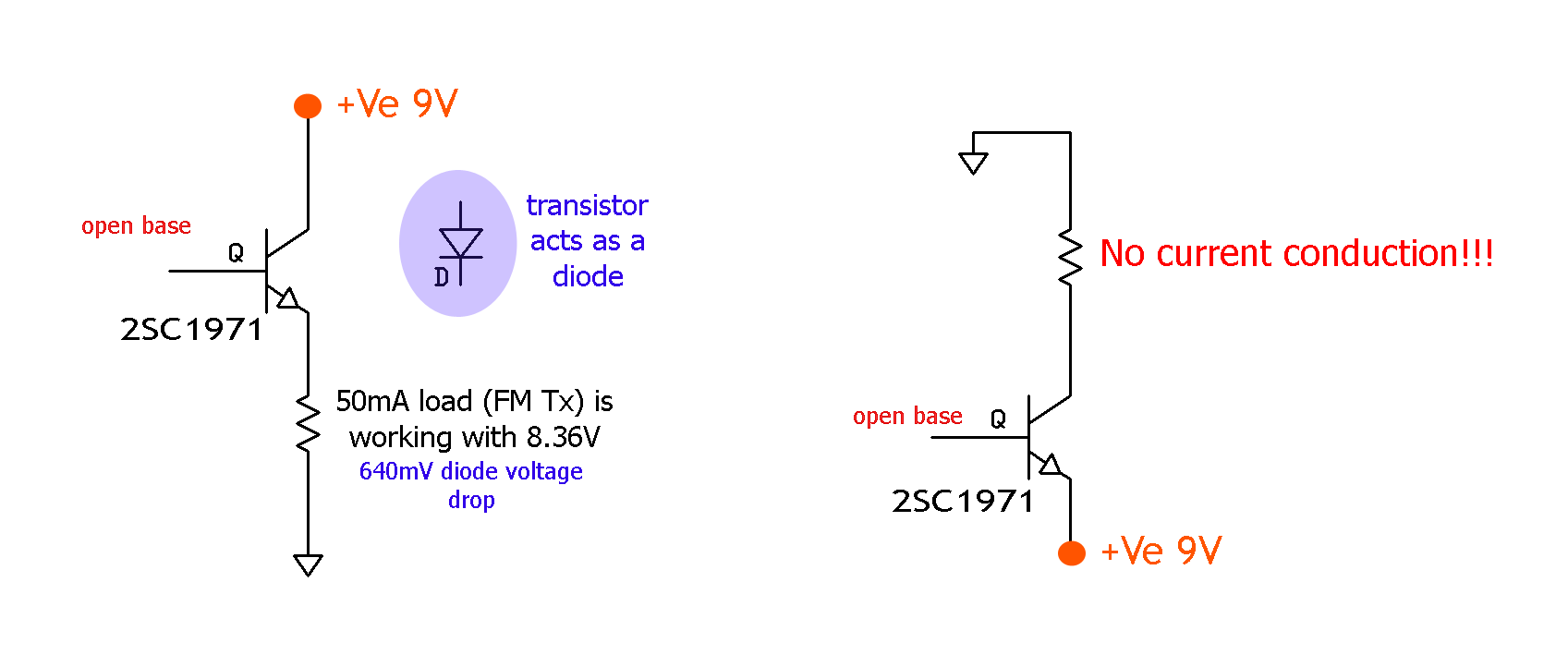

Last time I bought a new C1971 RF transistor. I tested its emitter to collector (emitter black and collector red probe of digital multimeter) using diode test mood; But I got around 600mV (like a diode forward drop). Rest of this unusual reading other testing are usual. Got fake then? Have you heared, found such situation?
If the base is not connected to a voltage then the transistor is conducting when it should not conduct so it is bad.
:( Some said about reverse protection diode on Mosfet but may not in transistor. Datasheet of C1971 has not included any internal diodes too. But it acts like a diode- shows no reading when red probe to emitter and black to collector but shows reading around 600 when black to emitter and red to collector.
I think I got fake brand! Oh my few dollars!!
Are you absolutely sure you're measuring emitter-collector and not base-collector or base-emitter? Pin-outs can be ambiguous/unclear on some datasheets.
I am sure it has BEC pinout. All other junction tests are usual But only one test- (black to emitter and red to collector) shows such reading around 620mV drop.

the proper pinout for a 2SC1971 is BEC, but there are counterfeits out there because this device has long been discontinued.... the only proper way to test the device is to test it with a beta tester, and make sure it has somewhere near the expected Hfe when connected properly... the counterfeits have C as the center pin and heat sink tab, and will not provide any gain with C and E reversed on the tester. the purpose for using the center tab as E is quite simple. the heat sink tab makes for a rather large stray capacitance. if this stray capacitance were in the collector circuit, it would make the proper design of an RF amp very difficult. using E as the tab simplifies things, since in most RF amps E is always grounded, and the stray capacitance between the tab and heatsink doesn't matter.

Hi all,
look these bias, recently I tested the transistor like this way. I think this situation is transistor failure, isn't it? I think transistor won't work in Class C RF amp in this situation. Supply will short instead, isn't it?
Then should I have to say- it is 100% fake transistor?
