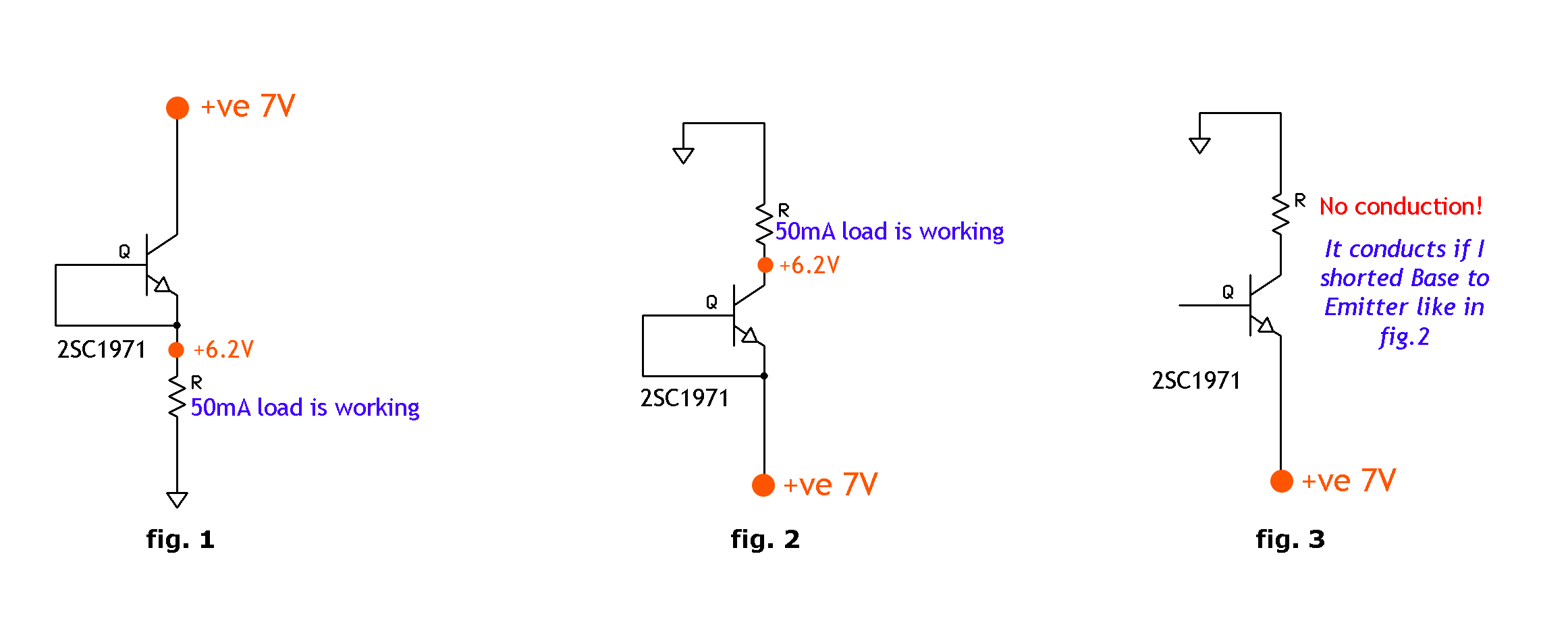

An old cordless phone where the same value (C1971) transistor was used as an output transistor and it has a 22 ohms Base to Emitter external resistor on its PCB. So I guessed that there is no internal Base to Emitter resistor inside of the transistor (I don't know more :) )
Look at the attachment, I tested few conditions. What it means?
Looks like there's a collector-base short or, as AG mentioned, that junction has high leakage.

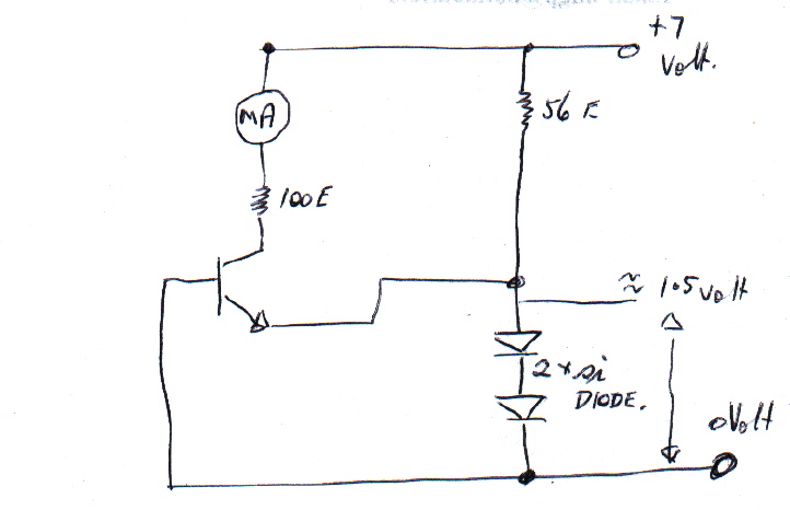

try this test set up.
Ic MUST be zero
Ib must be zero
IF not then 2sc1971 is us.

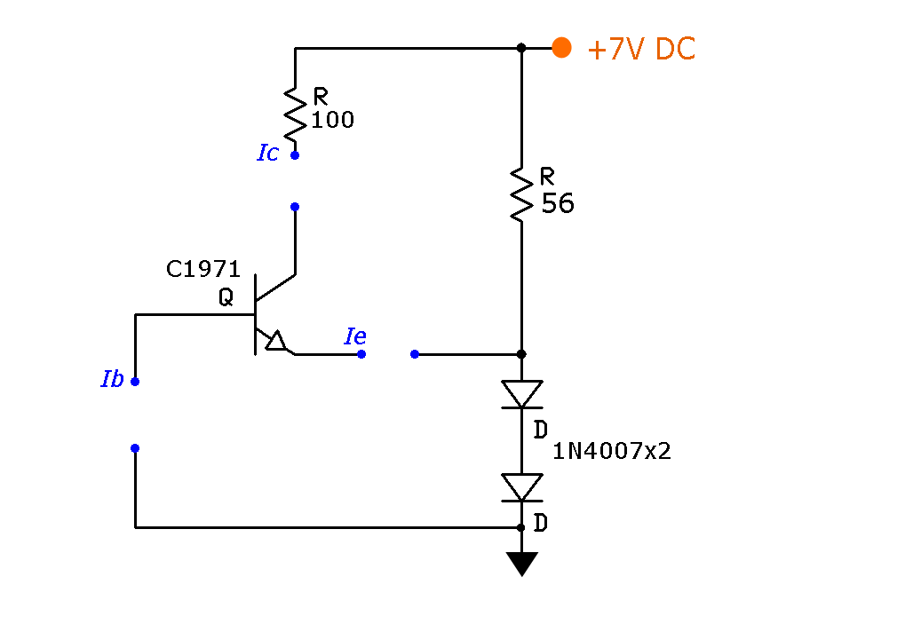

Did you mean to say- current throught these points (Ic, Ib, Ie)? OK will do and will say.

Hi again,
Some said transistor might has reverse diode (Anode connected to emitter?) inside transistor but it acts as forward diode (anode connected to collector) so positive supply directly goes to emitter/Gnd throught the diode
I did almost all simple tests-
-- I shorted emitter to base, but still transistor is conducting.
-- I biased the transistor with collector resistor- 1k and variable pot 50k for base. I measured collector voltage but I got 0.14V to 0.70V up-down by changing pot resistance. Then pot burnt out badly. I used fixed base resistor. 5k gave 0.14V, 10k gave 0.20V and 47k, 100k, 4.7M or no resistor gave 0.7V.
-- I made a circuit suggested by rumpfy (at last) but used 1k collector resistor and another was 220R and got
Ic=6.2
Ib=3.6
Ie=2.6
What it mean?
The purpose of the test circuit was to reverse bias the base emitter junction.
if you are seeing collector current with the circuit I drew, I think you can say the transistor is US.
