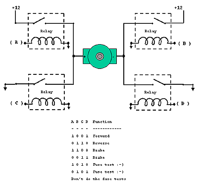

I have been searching some more on this myself and found that a 'H-Bridge' is the most common way of achieving what I need.
The attached image shows one diagram I found which looks really easy to setup... but I am a little concerned about the lack of protection if one of the relays kicked in at the wrong time..

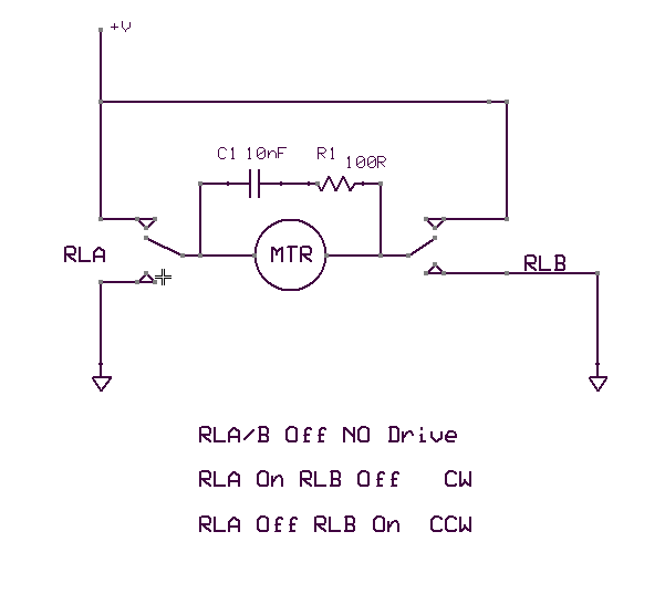

If you just want to drive the motor CCW and CW at maximum speed you dont need that bridge.
Consider that you have two relays, one wire of the motor is connected to the wiper of one relay and the other motor wire to the wiper of the second relay.
You connect +V to opposite ................................
I'd better do a diagram it will be quicker...:)
Like this ?
Like this.
The CR is for noise suppresion.

In the circuit posted by ericgibbs...what is the use of the capacitor and resistor across the motor?
The capacitor and resistor is a snubber network which takes some of the strain off the relay by absorbing the high voltage pulse given off by the motor when it's turned off. It also helps to improve EMC by absorbing the high frequency noise generated by the motor's commutator.

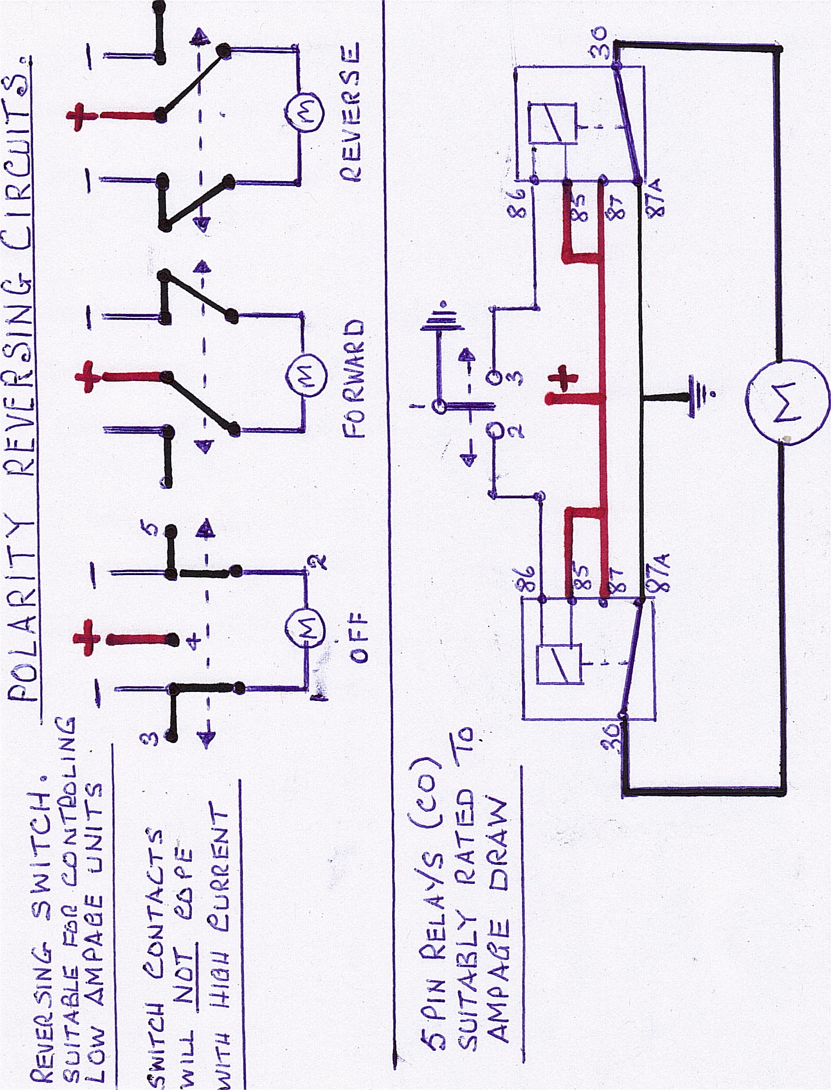

Reversing the polarity with relays is quite simple ,all you need is two 5pin relays(crossover) & a 3 position switch.I've attached a pdf for you,
Page#1 is reversing polarity & Page#2 is speed controling.

Hi Ficticious,I will gladly help you,but am not sure what you need to know,you need to be a bit more specific.So I'll start with a few simple basics.A DC motor can run in either direction,by just reversing the polararity.to do this a simple reversing switch is suitable,providing no HIGH Ampage is involved;(you can get a switch from a car breaker's yard or an electric drill)Most circuits will indicate that both the motor terminals are connected to ground,when the switch is OFF,When the supply to ONE of these terminals is supplied with + ,the motor will run.the reversing switch simply changes these connections around.If the motor draws a high current you HAVE to use relays,suitably rated for this.a relay is in fact a switch that can be controlled by a low ampage supply (thinner wiring) it has two seperate circuits,the energising (low)& the high ampage contacts.The crossover relay (CO) is a 5 pin relay,which changes the supply from 30 to 87 & 87a ,it can be seen that 1 of these pins is ON & the other is OFF,when the circuit is at rest.The circuit I've shown is contolled by a simple 3 position switch.which alternates from 1 relay to the other.O.K that's the basics,let me know where you are from,and I will probably be able to comunicate in your native language.Gutten targ TERRY.

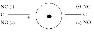

hi .............can u plz help me wid NC NO and their respective +v $-v.....i dnt know abut dere working........and how they can b used as a switch????????

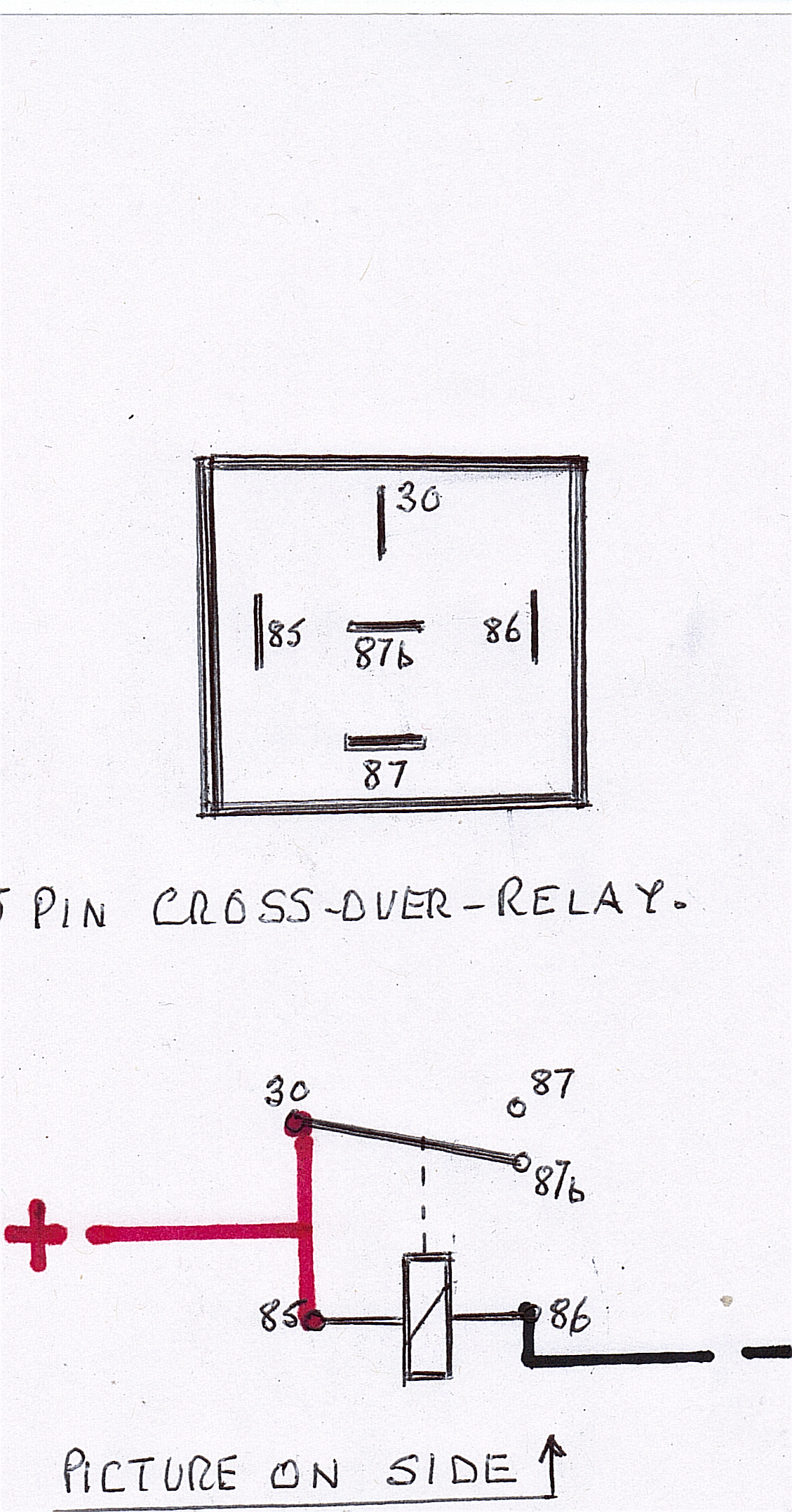

If you are having trouble identifying the suitable relays,check the thumbnail below.There are several types of 5 pin relays,make sure you get the right ones,they don't all do the same function,just check that one of the pins marked 87b is on,& 87 is off.

Bonjour Fictif, un relais est un Interrupteur,Contenant Deux Circuits,ONE est de dynamiser le relais,cela peut se faire avec CABUAGE BASSE AMPAGE,L'autre circuit est capable de faire face A HAUTE CURRENT,qui empeche les contacts de BURNING OUT. 5 PIN LA CROIX SUR RELAIS A DEUX PINS. a DYNAMISER,ET TROIS PINS POUR LA CONECTION DE LA POWER.When Le relais est off,il existe un code pin conection Entre 30 ET LE RELAIS 87a,When ON Est,iL N'Y A CONECTION entre pin 30 ET 87.
Vous le verrez dans le schea,que les deux terminaux sant relies MOTEUR A QUAND LA NEGATIVE 3 position switch is OFF,By COMMUTATION SUR UNE ALIMENTAION EN RELAIS seqa POSITIVE DE COURIA,PARLA SELECTION DE LA POSITION D'AUTRES RELAYS VARIATION SUR SIMPLE.
bonne chancel Terry.

Post #6 by Eric uses SPDT two each. Eric's design was based on what the original poster had on their relay card. A single DPDT relay could be used very easily also.

Hi Kirkhan, To identify the 5 pin crossover relay,read my post #15, the circuit is post #17, and a PWM speed control circuit is post #11, if you need any help just ask, good luck.
