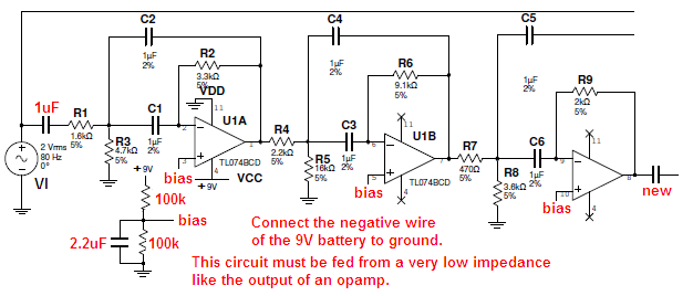

Hello everyone.
Thanks to one of the contributers here, I used the TI filter program to make a good filter for a friend, but now, I'm trying to avoid using a dual supply so it can work on an effects pedal power (9v adapter) But the only problem Is I can't manage to figure out how to bias it correctly.
I tried changing all grounds to the bias voltage and changing the negative supply to a ground but that didn't work, I tried putting a 1M ohm resistor before biasing the amp at the v+ supply but didn't work either.
I could really use some help.
Thanks in advance,
Maor.
  • Filter michel.pdf
Everything that was "GND" should be biased to 4.5V and pin 4 of the opamp should now tie to GND instead of -9V
Sorry... with the 14 pin package, it's pin 11 that ties to GND
OH... also don't forget the input source return has to be biased up to 4.5V as well.

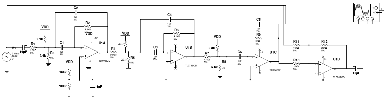

Well I agree that the potential dividers can be removed and the gain reduced.
However, for educational purposes, here's how to convert it to a single supply with the potential dividers left in.
It's pretty simple, double the value of the resistor and use two, forming another potential divider across the power supply. This works because the impedance looking into a potential divider, is equal to both the divider impedances in parallel. I've rounded all the values to the nearest E24 value, for example for the 4.7k resistors, double that gives 9.4k, the nearest E24 value is 9.1k.
Another potential divider and a capacitor is added to all the other points of the circuit which are normally connected to 0V.
The opamps have Fet inputs so the bias voltage does not need to be a low resistance. The bypass capacitor I used has a low impedance.
I forgot to add AC coupling capacitors to the input and output - I've edited the schematic.
Uhm, Trying to bias without connecting input return to bias doesn't work.
It seems that changing all the grounds to bias only works properly.
Also, the circuit changed, the whole point is to cut the 400Hz and the 2.5Khz points.
  • Filter michel2.pdf
The "half the supply voltage" DC bias voltage is needed only at the (+) inputs of each opamp. R3, R5 and R8 must have a very low impedance connection to ground which is best if they connect directly to ground. The value of your filter capacitor C13 is much too small to make the bias voltage without a signal so everything in your circuit that connects to the bias voltage have signals all mixed up and the spec's for the filters are also messed up. Maybe that is why your circuit works only when the input return is also connected to your high impedance bias voltage.
What feeds this circuit? It must have a very low impedance like the output of an opamp.
Why are you using bandpass filters when you actually want notch filters?
I used the TI filter pro to make the design of this filter, I set it to notch, why do you claim that its a bandpass?
also, what do you mean by feed, if your referring to what powers the filters its a 9v at 200mA ac adapter, the common one for effects pedals, else I have no idea what you mean.
So what should I do in this situation?
