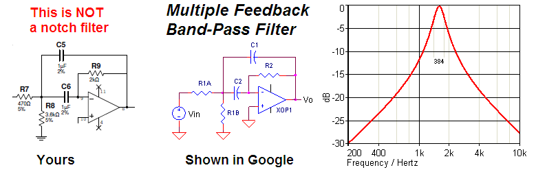

How do I change this to a single supply filter?
I used the TI filter pro to make the design of this filter, I set it to notch, why do you claim that its a bandpass?
Because it is called a Multiple Feedback Bandpass Filter on thousands of sites in Google.
also, what do you mean by feed?
What is the input, what feeds this circuit? A high impedance guitar pickup? A preamp circuit with a low output impedance?

If its a bandpass filter how come it works like its supposed to? (it does cut the 400 and the 2.5K)
It's going on an effects chain so I guess high imped.
R3, R5 and R8 must have a very low impedance connection to ground which is best if they connect directly to ground.
Yes, you're right, there's no need for lots lots potential dividers, the inputs are capacitively coupled so it's fine to connected the resistors directly to 0V.
It passes mid-bass frequencies, passes mid-range frequencies and passes high frequencies. It reduces frequencies in between the bandpass filters and also cuts fairly low and very high frequencies.
The first filter must be fed from a very low impedance like the output of an opamp.

Also, if I use a buffer before the circuit, will it lower the impedance?

Most buffers have a very low output impedance.
