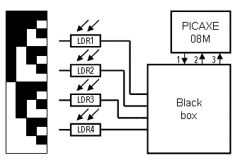

I removed some IC's from a dead video machine. One is MC14066B. It’s a 4066 type quad analog switch. The other is a quad nand.
Now I want to control a switch with a LDR. How do I do that? It's going to be part of a picaxe project. Input and output will have to go to and from the picaxe. I have to be able to adjust the sensibility of the switching.
/Allan
To be more specific.
I want a pic to read a binary pattern on a paperband using 4 LDR's but only 3 pins. When pin 1 is low, LDR1 and LDR2 is read. When pin 1 is high, LDR3 and LDR4 is read. But LDR's not very digital, so I want to make them switch a digital switch. I know I can do this by transistors. But there will be a lot of Transistors in this circuit. The two IC's I found could maybe be used.
What do I put in the black box?

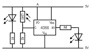

A part of the solution
Hi myself
Here is a part of the solution. You got to put the LDR in serie with a resistor R2 to make a voltage divider. The resistance of R2 has to be near the resistance of the LDR at the light level where switching shall take place. If R2 is a pot it can be adjusted.
Place a LED beside the LDR. When the light hits a white patch on the paper, the LED will trigger the 4066 switch. The LED at right hand will then be turned on. When it hit a black patch it will be turned of.
What about R3 and R4? Will it be necessary to use both resistances? One to protect the I/O and another to protect the LED?
I hope somebody else will take part in this discussion whit myself. Course I'm just new to this stuff.

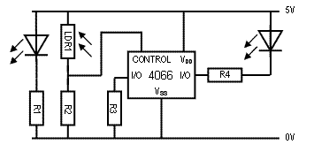

I've modified my circuit as shown below. I've turn I/O around. I skipped R3. It works fine. But I don’t know if the input can handle this in the long run. The output from picaxe will be the input on 4066 instead of 5V at point A. I need some help at this point. I know to little about pull down resistors and thinks like that. I don't feel secure about reading the datasheets either.
R1 and R4 is 330 ohm. R2 is 22K ohm.

Please comment on this. Will it work or burn or will nothing happen.

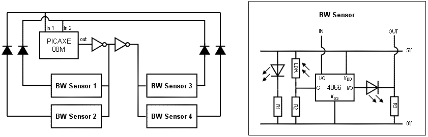

I found another solution.

I'm a bit suprised nobody has answered this. I don't know anything about PICS etc, but I might advise against using LDRs. They really are quite slow for an application like this. A photodiode is more suitable, but they are only really sensitive to infrared light. If you make your light source infrared, then you can use the detector I have posted. However, i'm not sure how infrared responds in terms of being reflected or absorbed by different colour materials. The detector will give a logic changeover in response to different levels of infrared light. The sensitivity is controlled by the 220k resistor (higher = more sensitive, but don't try and go over 1M).

The photodiode solution is very interesting. I will consider it in future projects. This project has advanced since my original posts. The only thing I kept in the original project was the LDR's. Fortunately timing is not essential.
Thank you very much for the reply.
